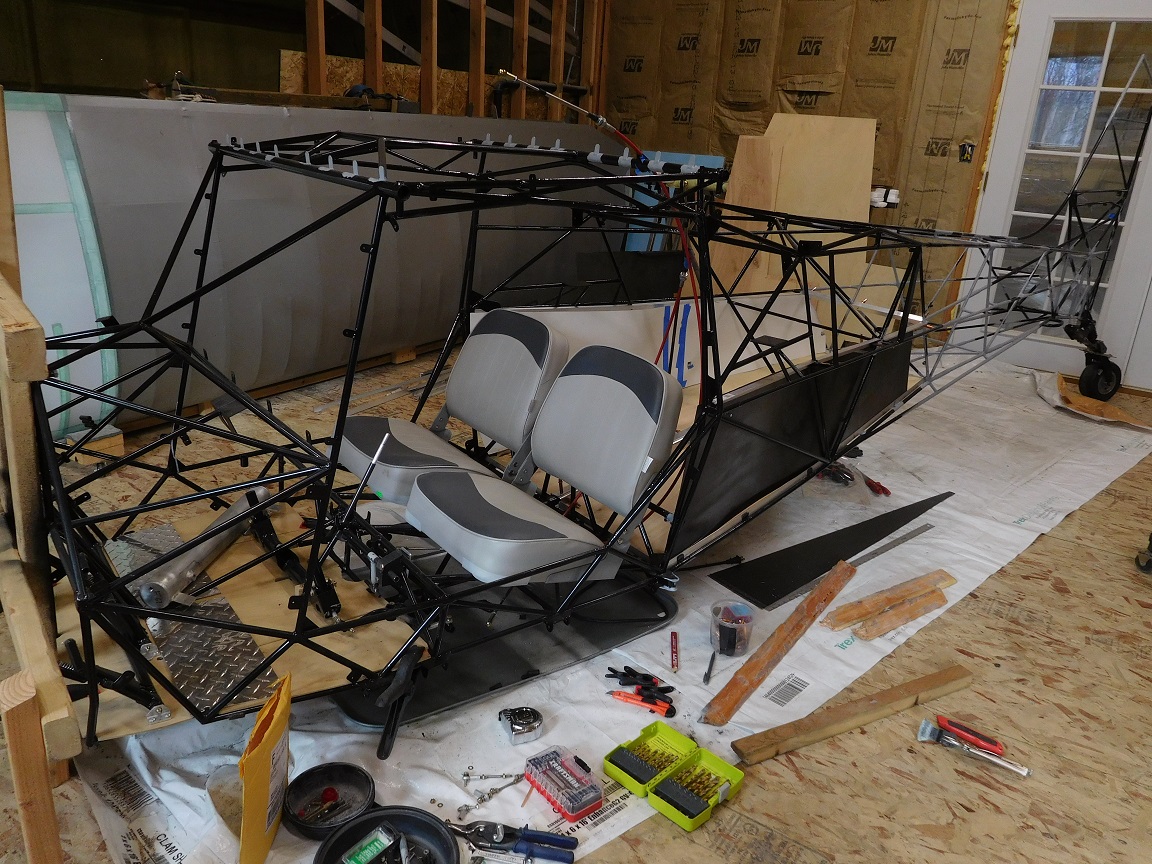

Do you have pictures of the boat seats installed?
Here are the ones I used in my Avid+

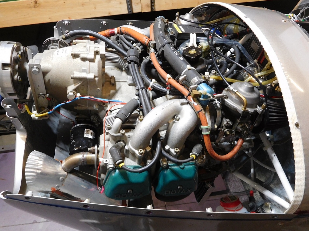

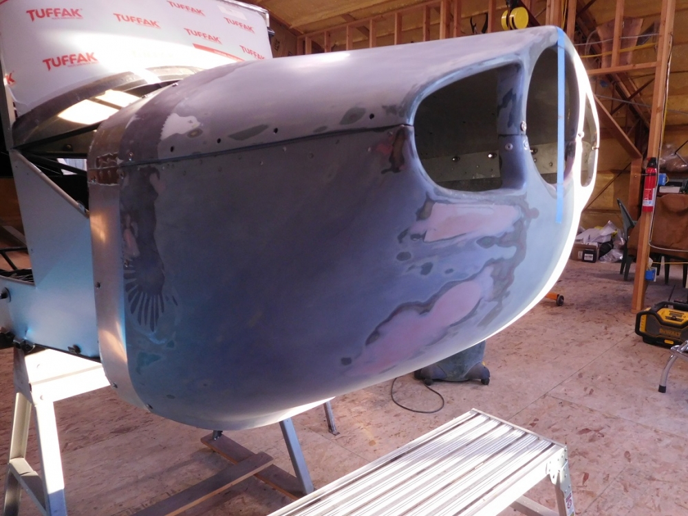

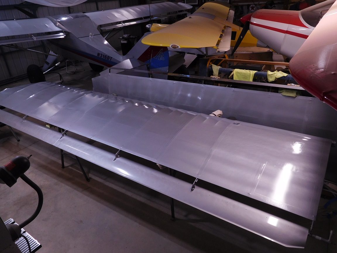

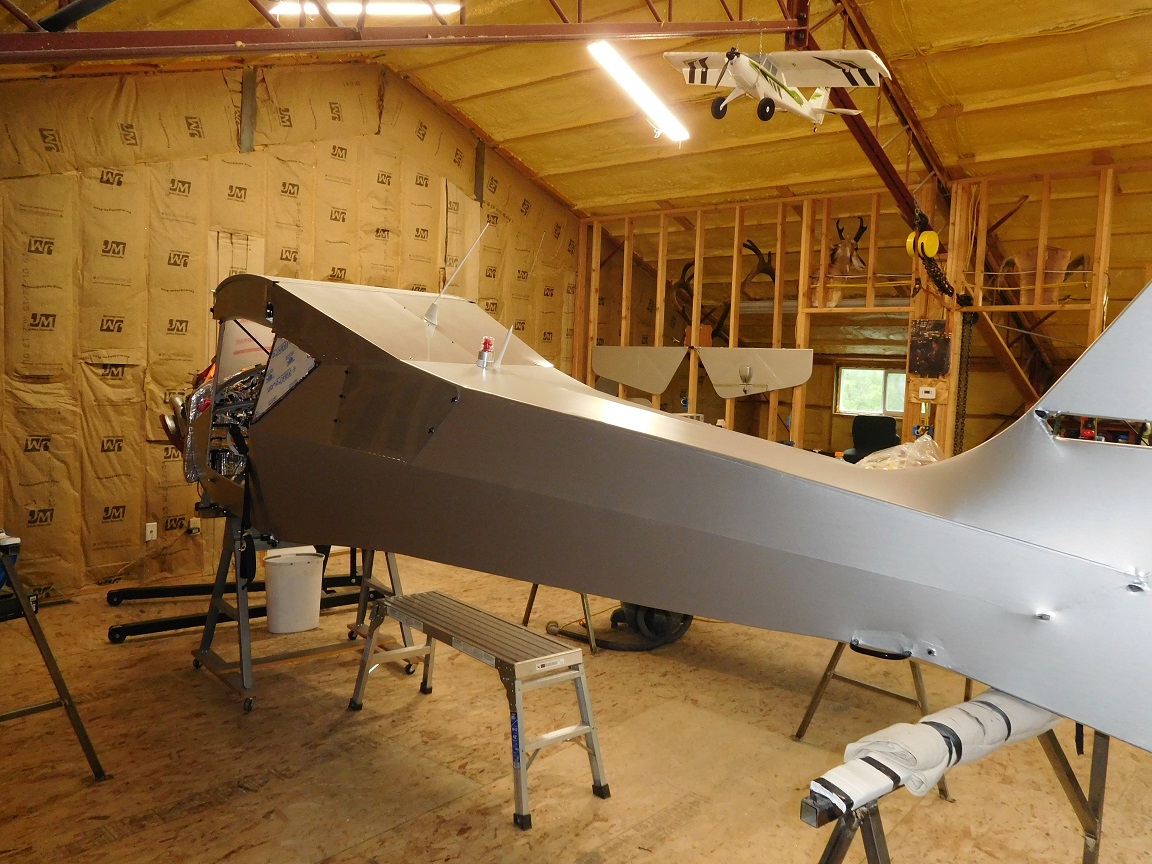

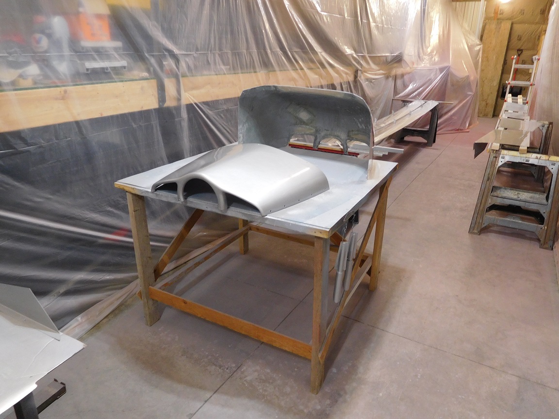

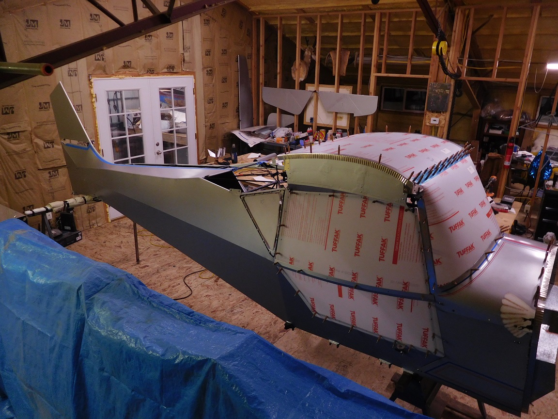

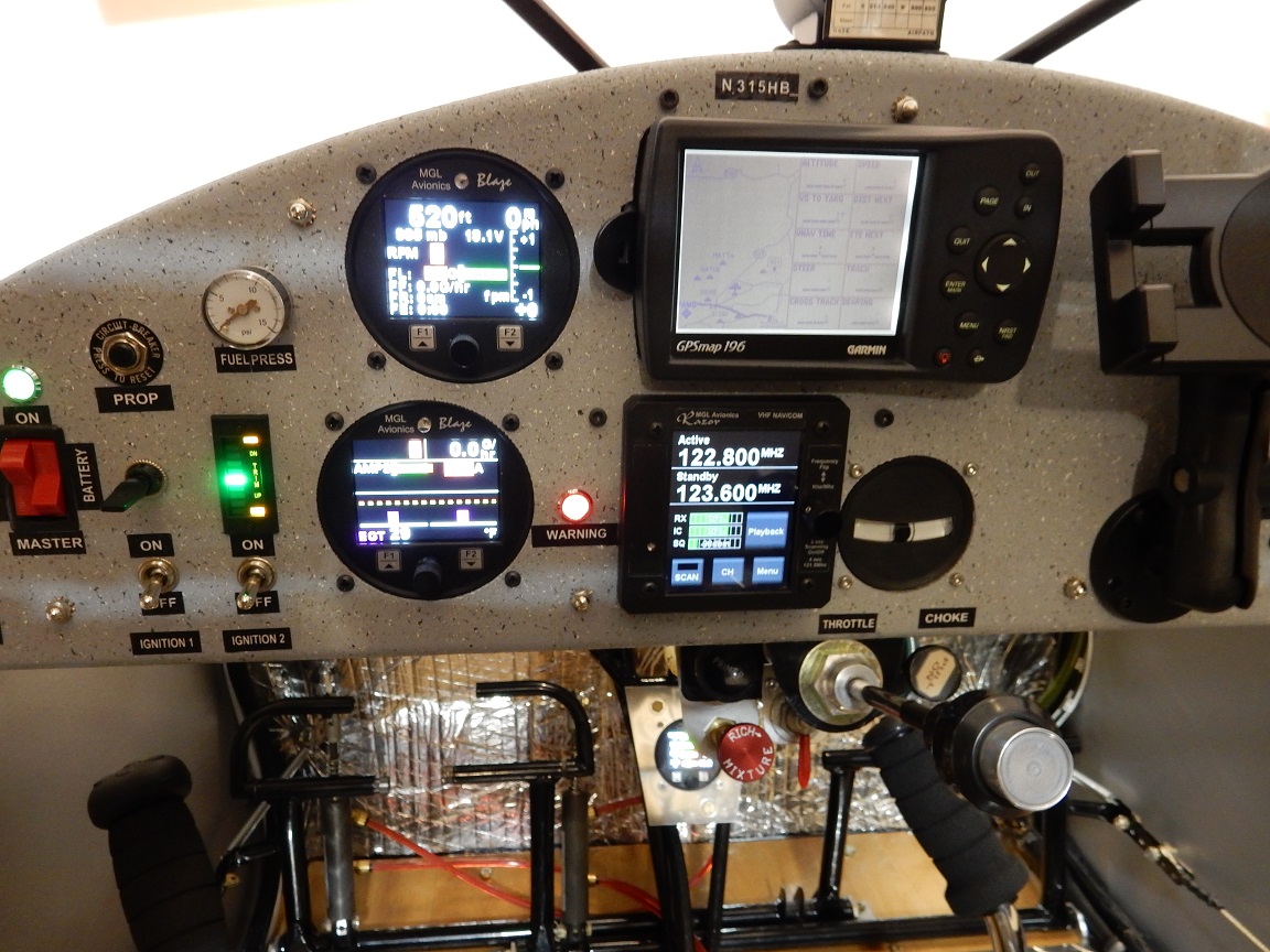

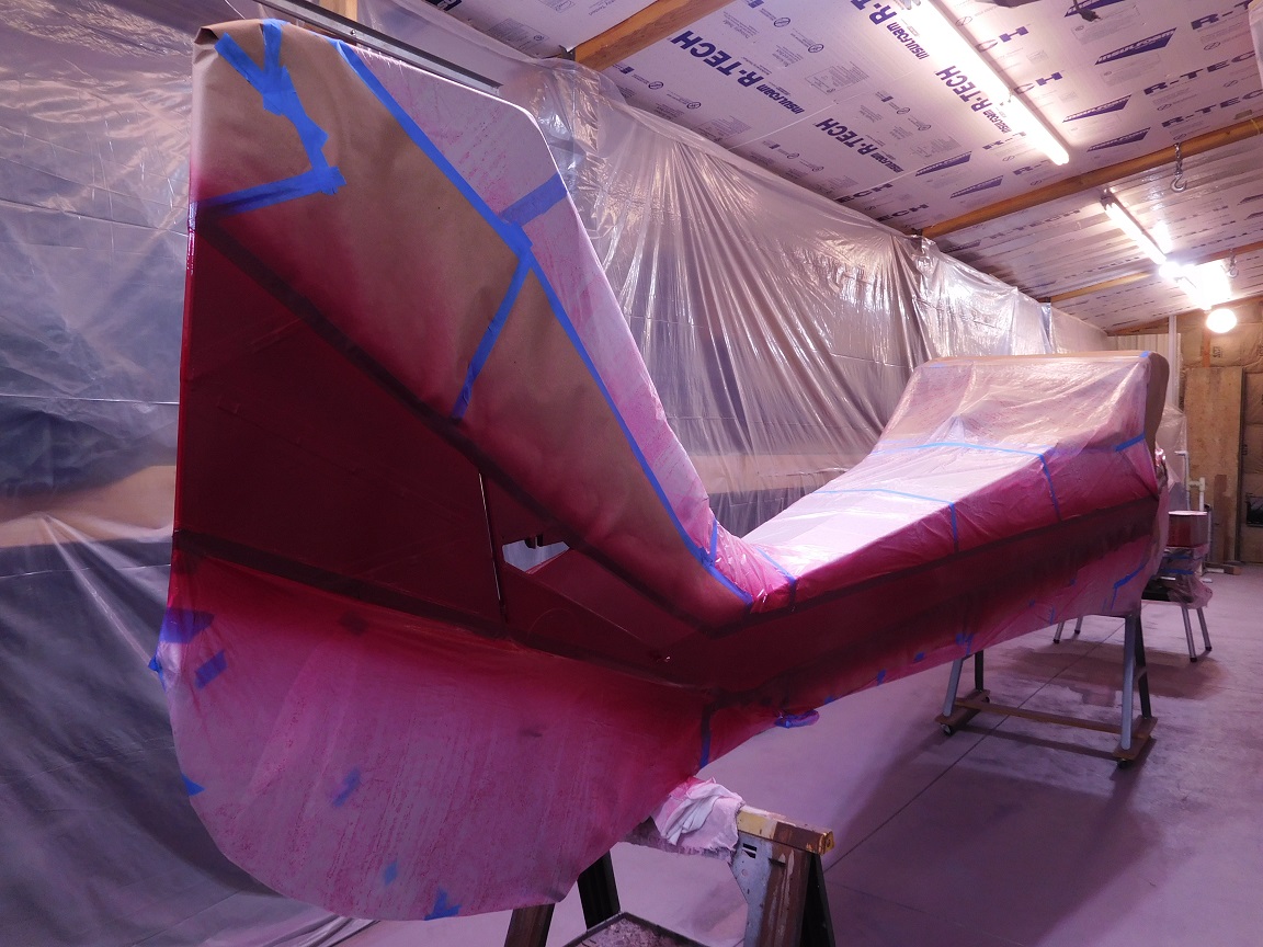

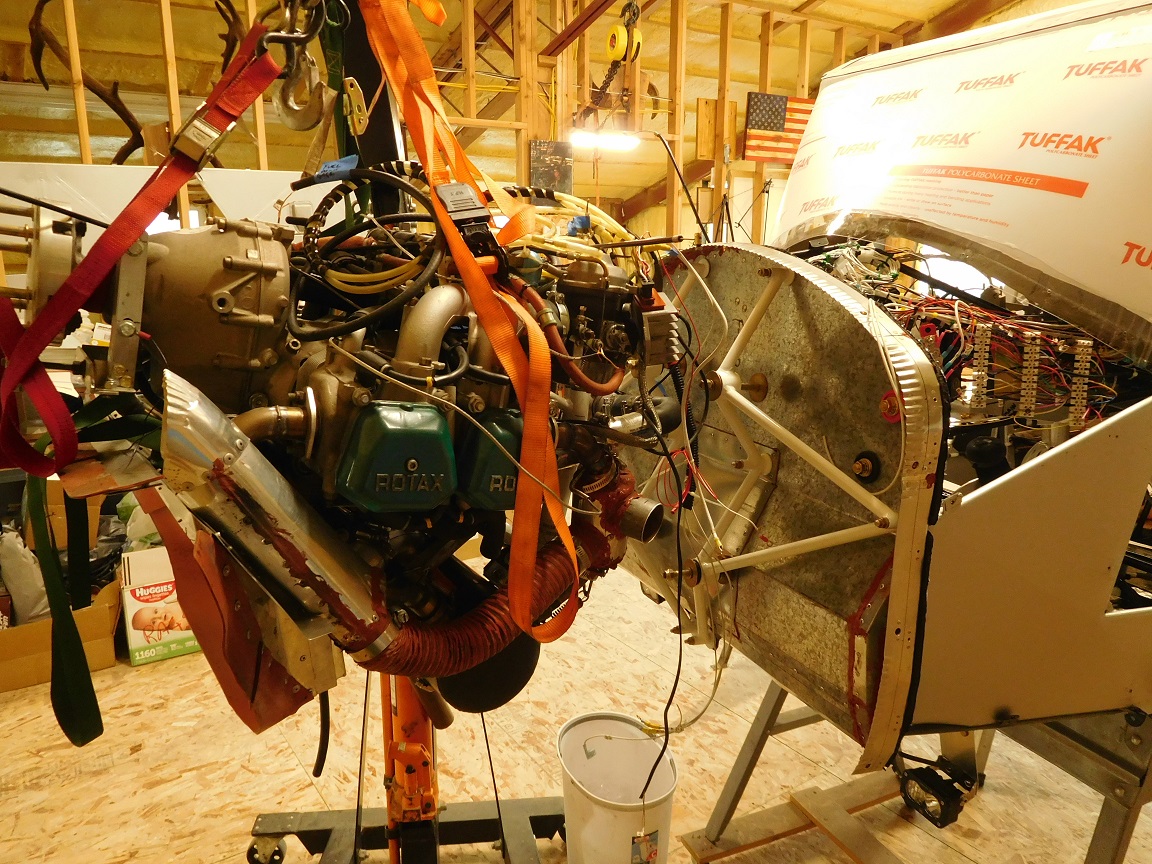

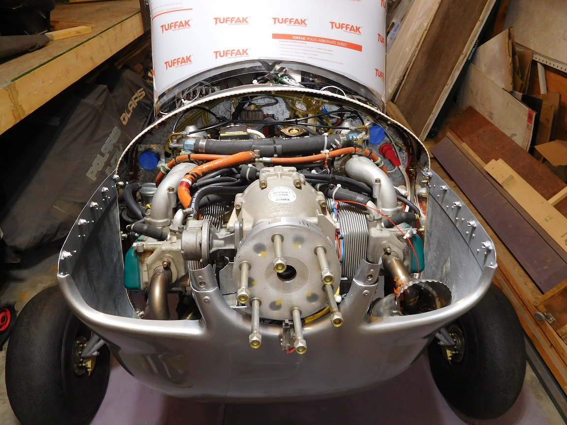

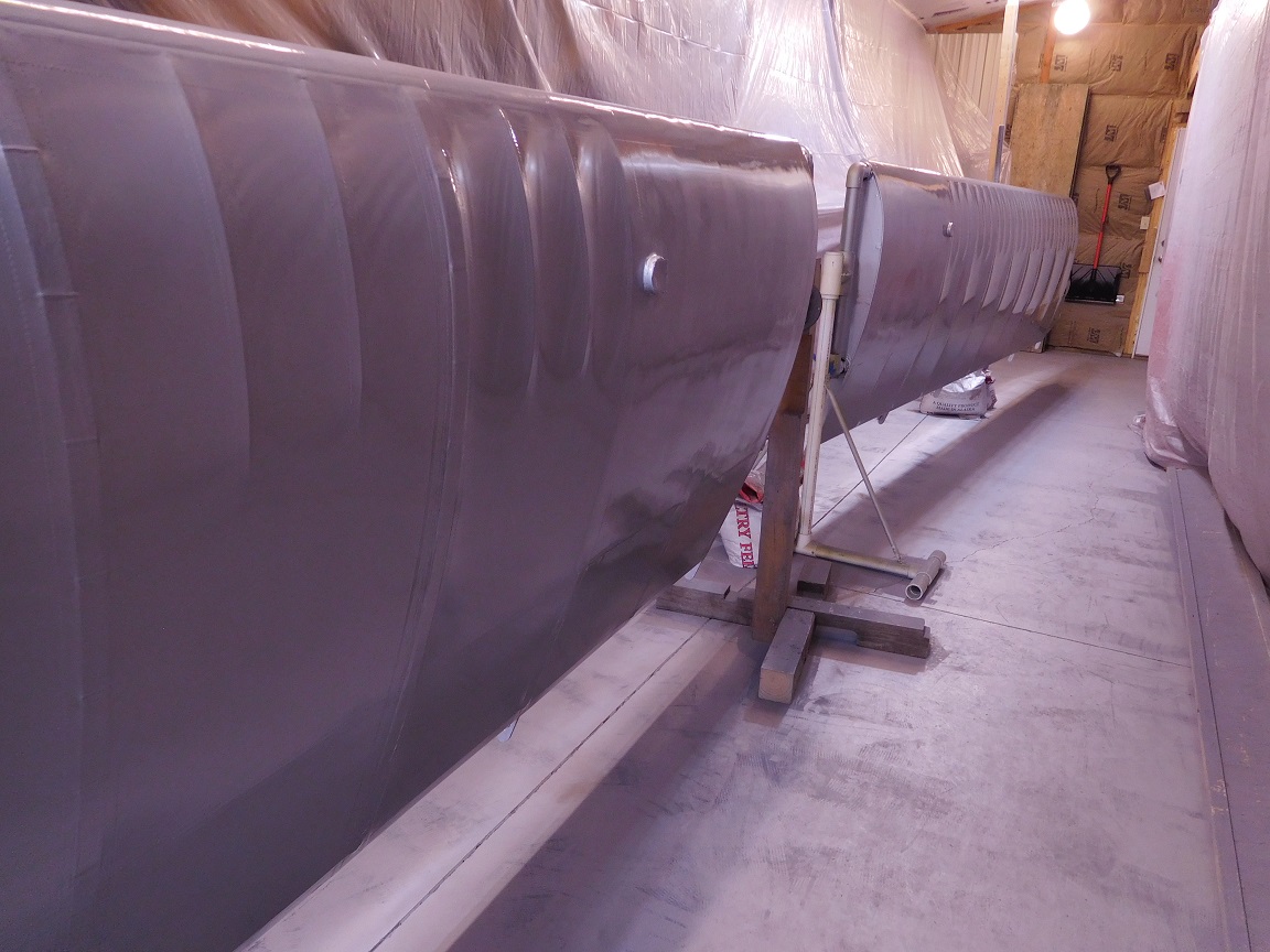

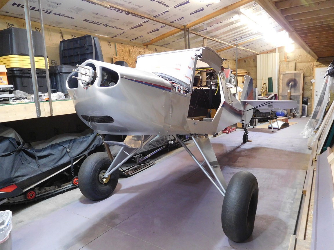

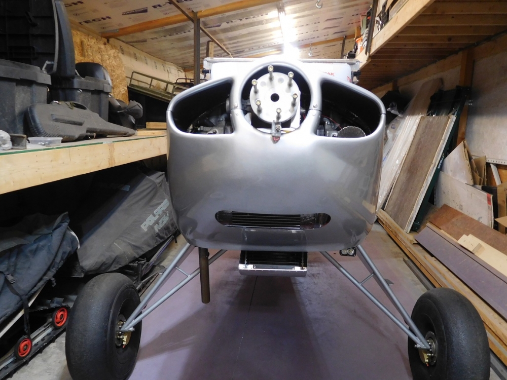

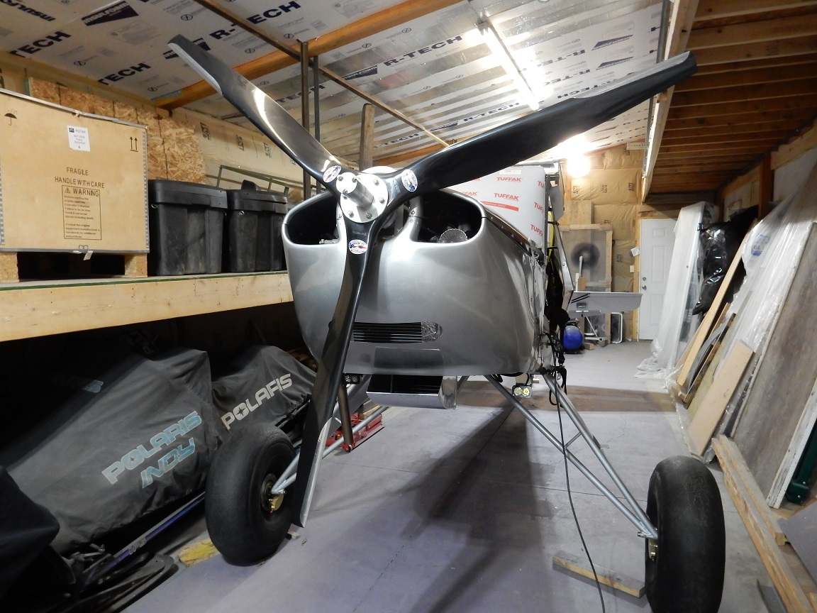

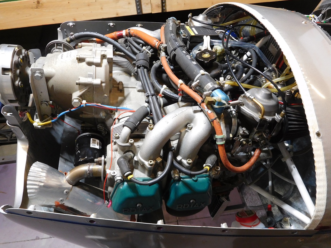

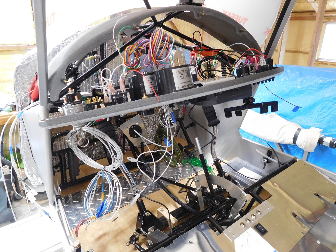

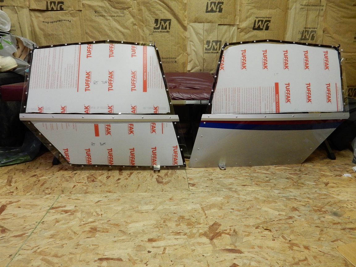

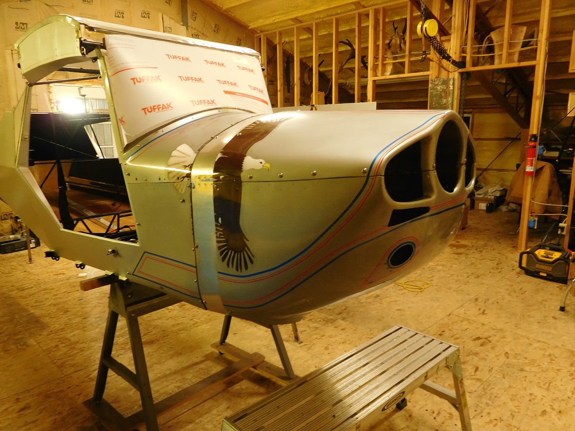

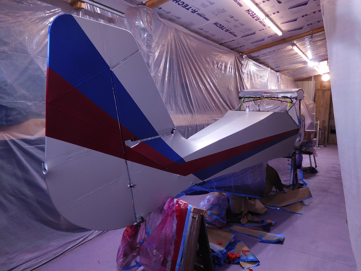

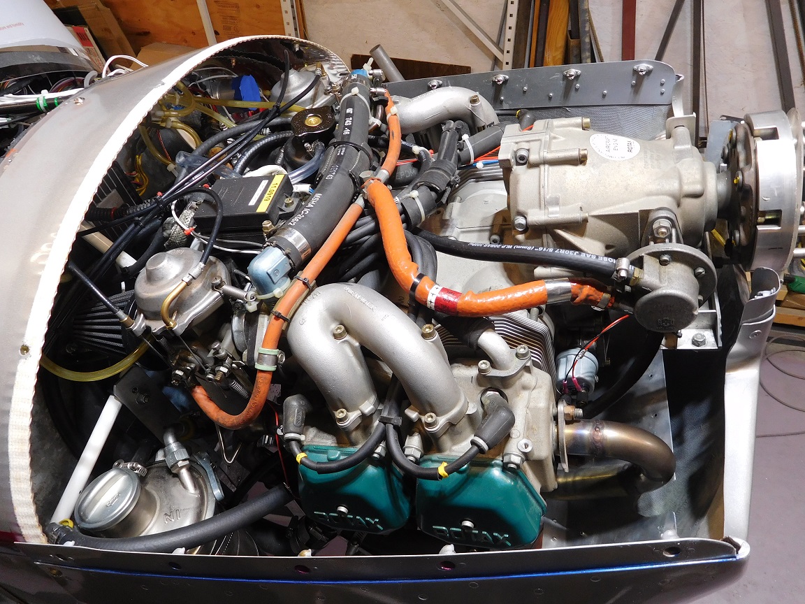

The Avid Mini + is getting pretty close to inspection time finally!  Painting is done on the fuselage and wings (whew!)  The engine mount built, and engine is on and ready to run. All wiring and instruments done.  Was just about ready to install the wings when winter hit.  I moved it into a side of the hangar that I can heat so I can apply the Avid+ emblem and N numbers.  Once wings are on it should be ready for inspection. It has come a long way since Jack and I chopped up the Avid MK4 fuselage and started this project.  A lot of this project is thanks to Leni for welding work!  Latest pictures:

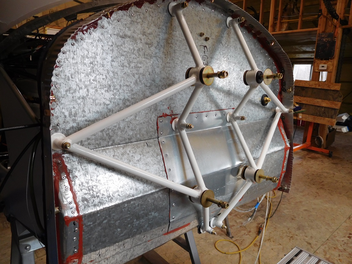

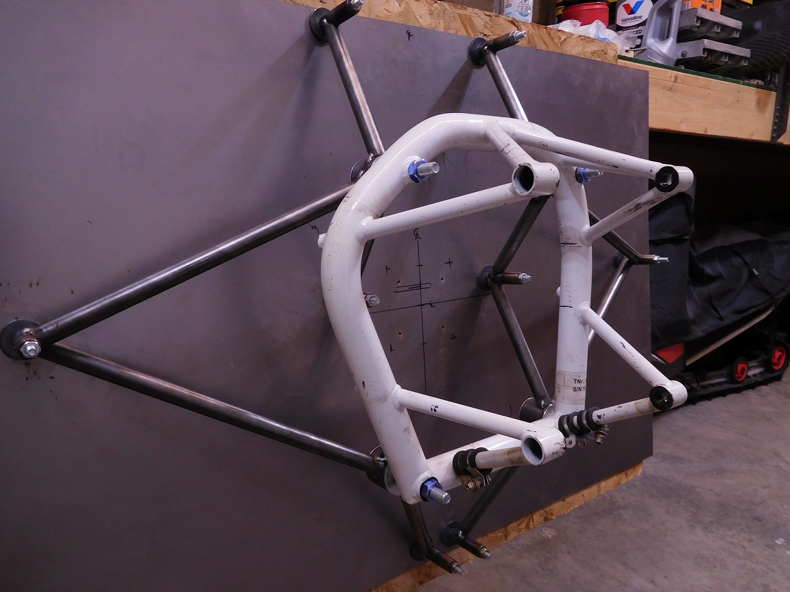

Thanks for posting up all the pictures.  I like the motor mount using the rotax ring mount as well.  How far is the front face of the prop flange from the firewall?  Is that the motor mount Leni made the jig for?  JImChuk
PS  Making the mount in two pieces would make it much easier to ship as well......Hint, hint  ;-)
Edited by 1avidflyer

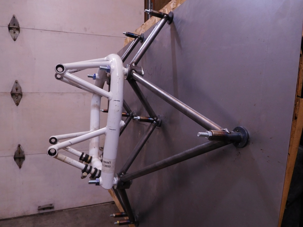

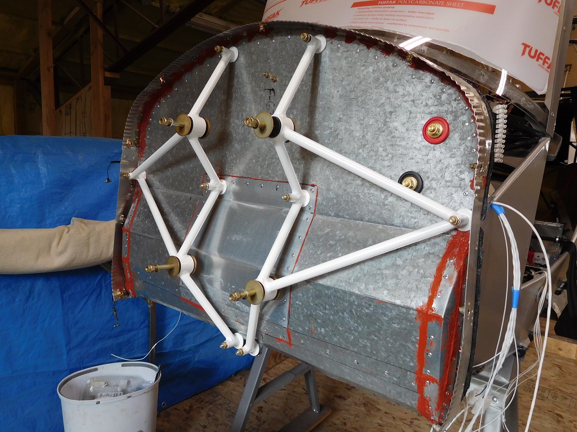

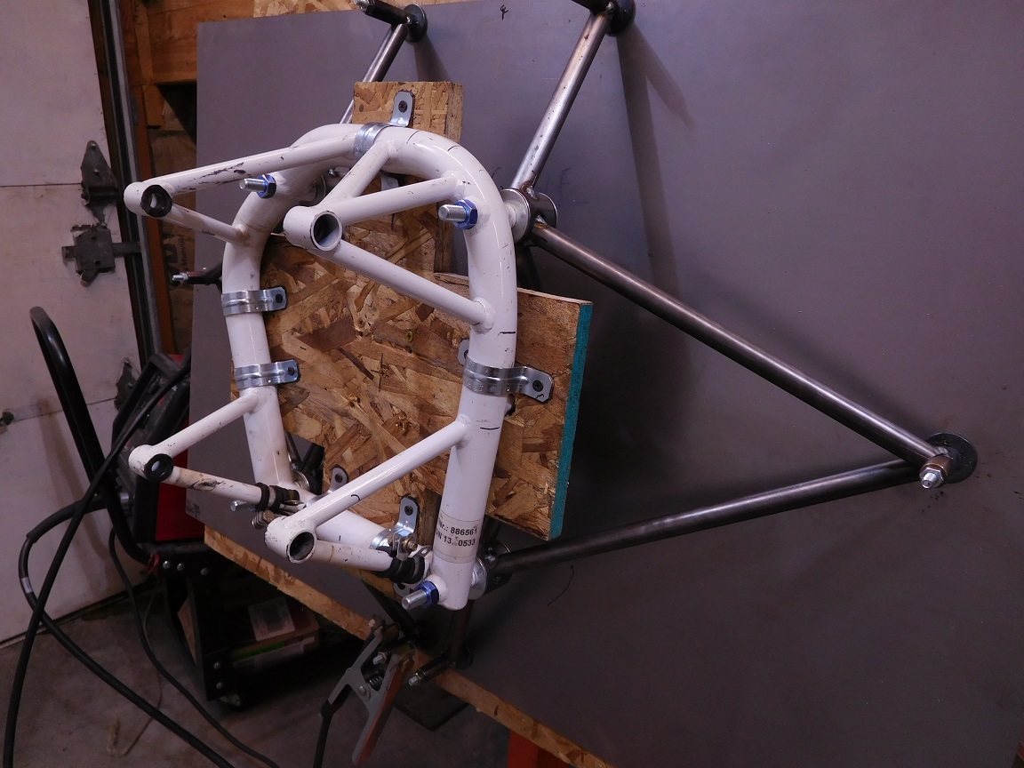

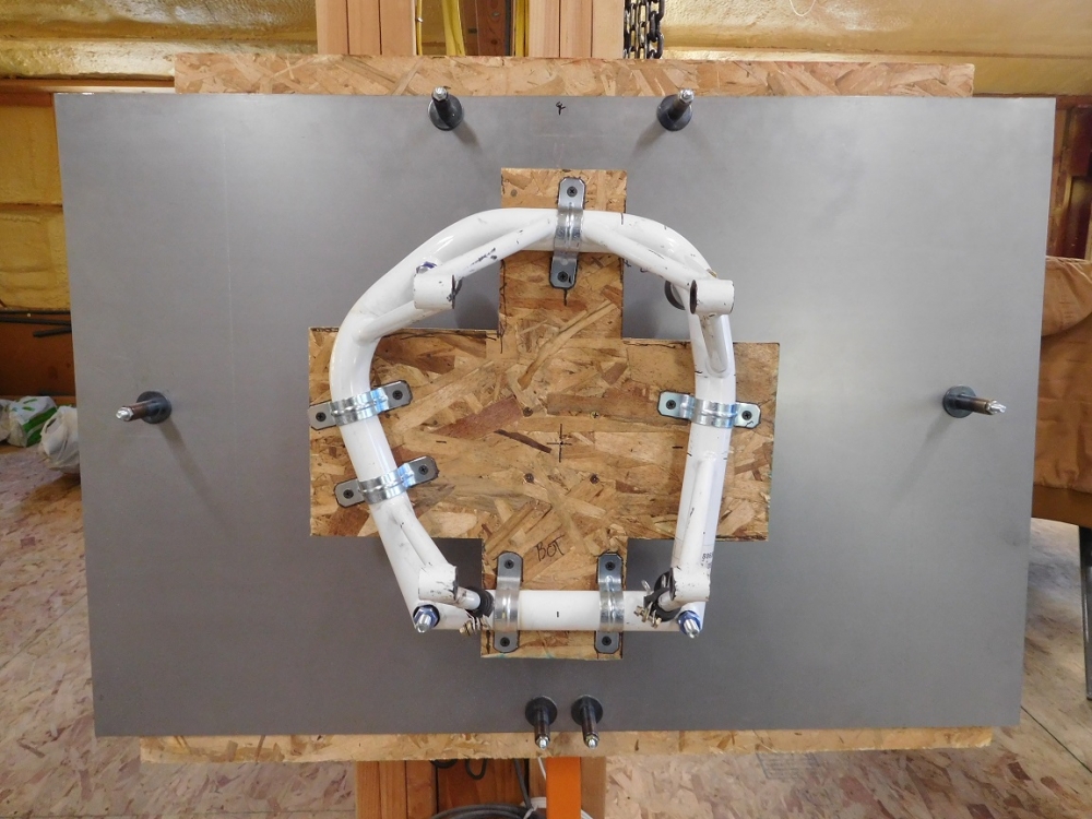

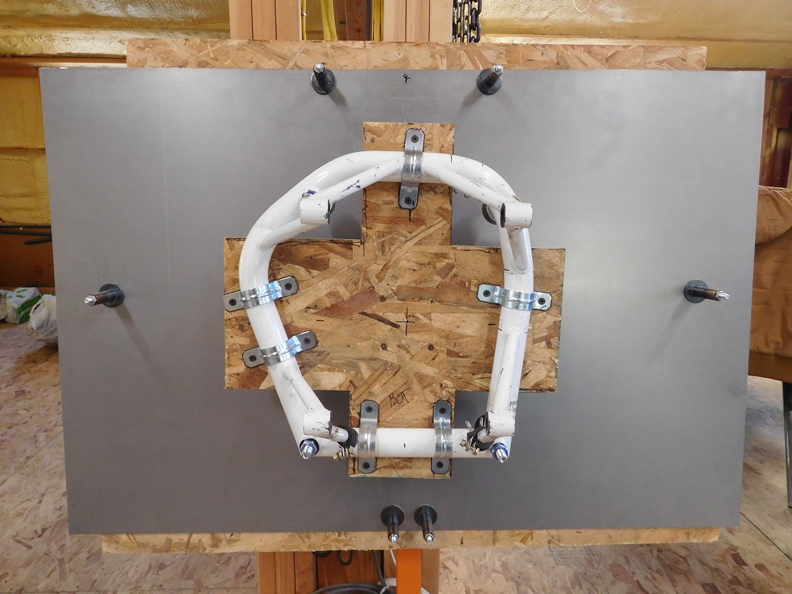

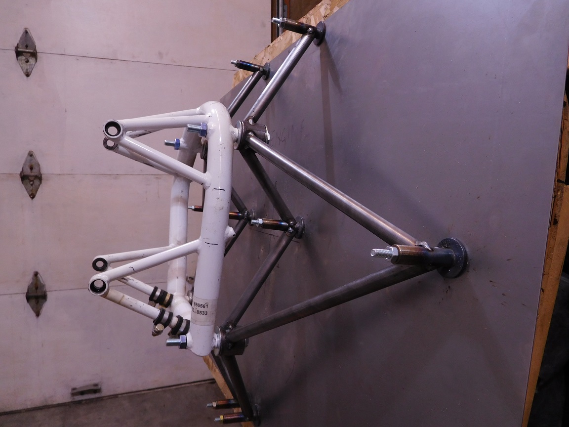

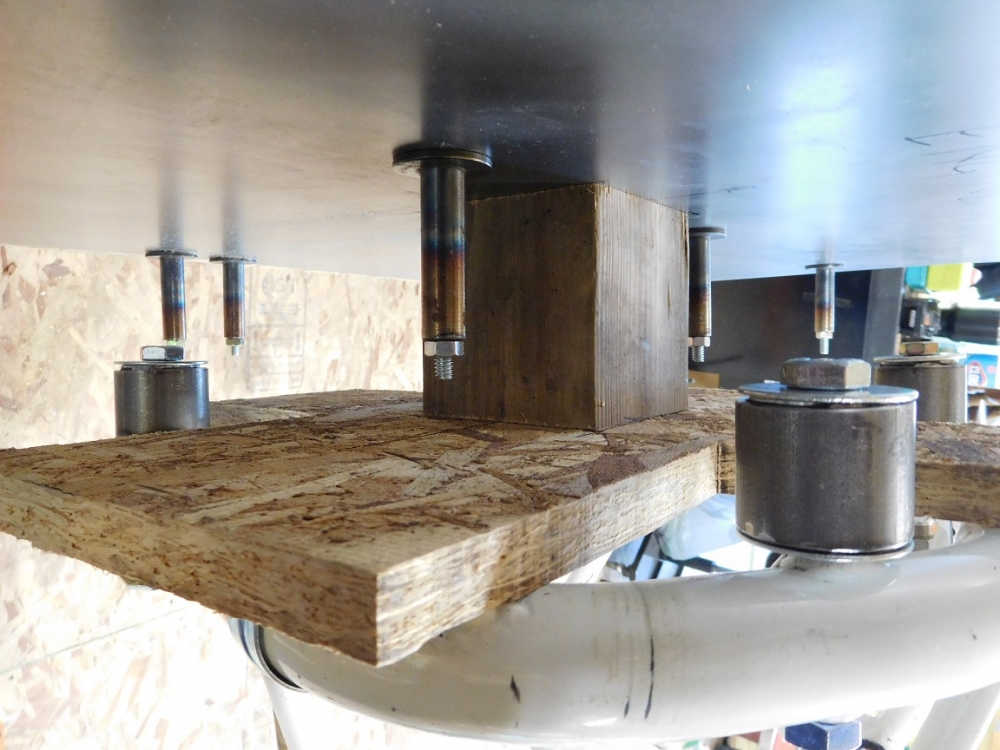

I ended up building this motor mount Jim (and did build it in 2 pieces).  The face of the prop flange is 27.25 inches from the firewall.

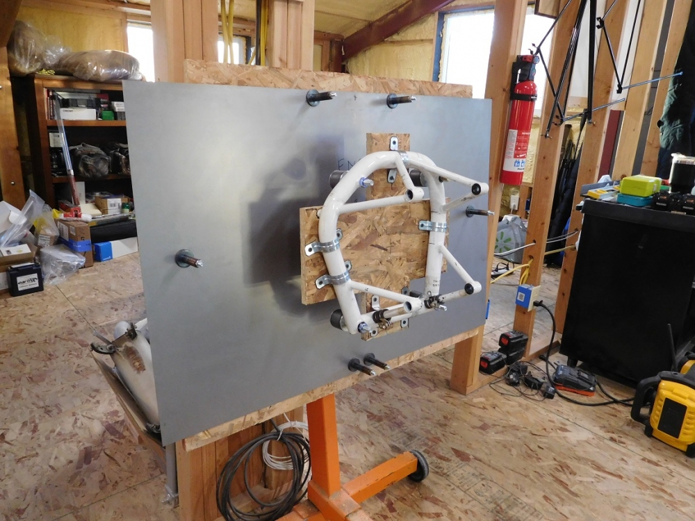

 I After a lot of measuring, sweat and finger crossing, to get the distance and position of the prop flange where I wanted it to be and where I needed to position the Rotax ring mount to get it there, it turned out as good as I could ask for.  I drilled a steel plate to match the firewall motor mount holes and built a wood jig attached to it to hold the ring mount in the position I wanted.  I fabricated the rings for the Lord mounts and a friend built the mounts at the firewall for me.  I cut, fit and tack welded the tubing to go between. Leni wasn't able to weld this one for me, so I had another welder do the final tig welding (since I don't consider myself and excellent welder). The pictures kind of show the progress.
If anyone wants to have one built to put a 912 on an Avid, he made a jig off the mount so he can build more.  I can pass on his info to them.
Thanks again Randy for the pictures and good info.  Is the engine tipped to one side or up or down at all?  I know on my factory built Jabiru motor mount, it seemed to be pointed straight ahead for side to side offset, and the prop was at 90 degrees to the wing spars.  Thanks again.  JImChuk
Hi Jim,
Right now it is mounted straight in line with the fuselage.  I shimmed the engine one inch forward from the Lord mounts though, using stacked 1/8" aluminum plates.  I did this on my Avid Plus as well because the engine mount was a little short, but I found that doing this allowed the engine and accessories to fit better and mount easier, plus, it also allows the engine to easily be offset up or down, right or left by removing and adding plates side to side or bottom to top, if you want to tweak it.
Randy
