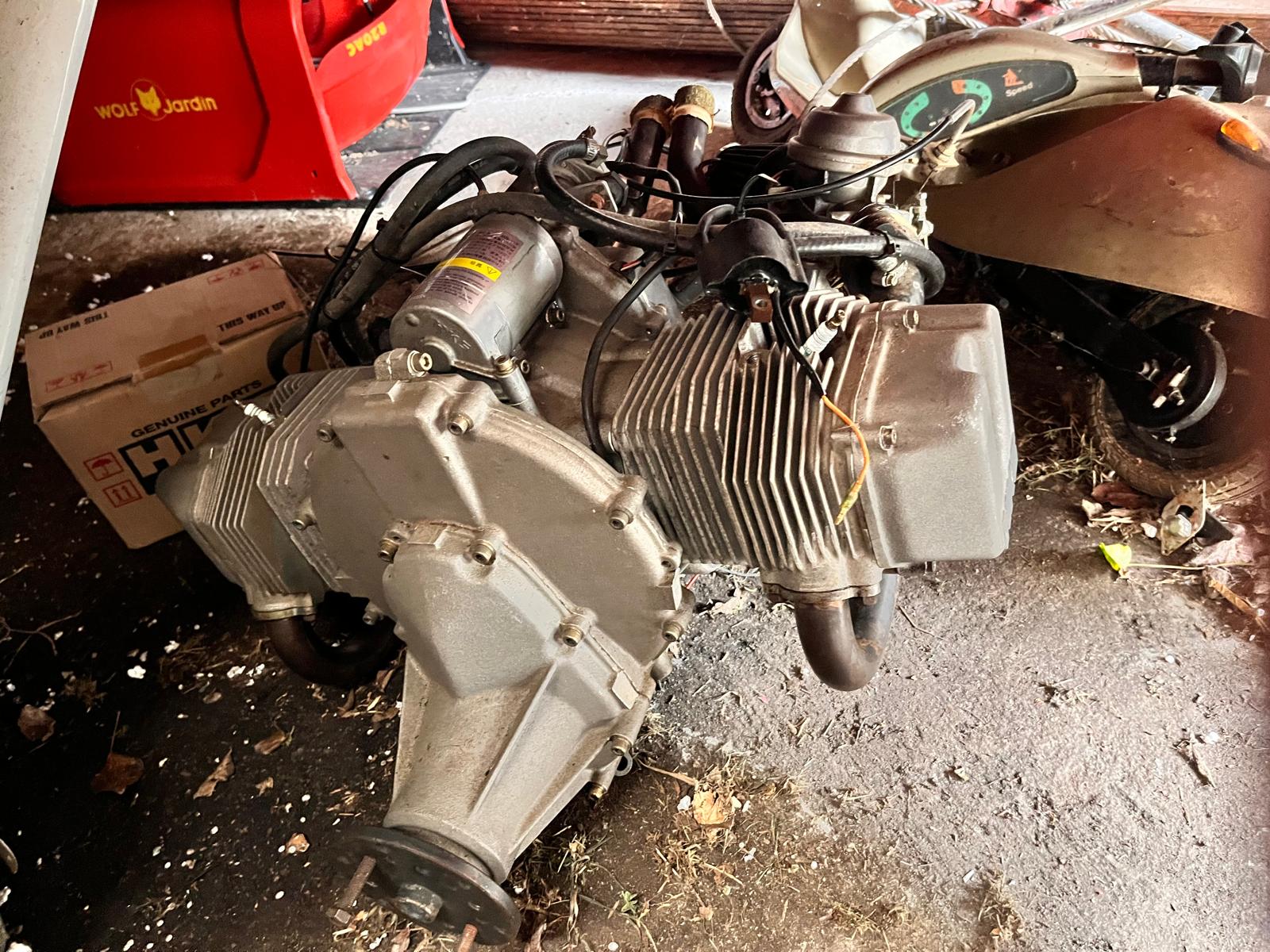

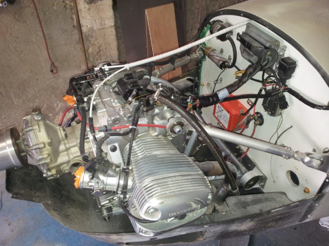

Hello Zadwit,
Sorry I understand this topic is from 2017, but I have just purchased a HKS700E, and I am also looking to mount it on my Kitfox III cell.
Did your project went thru?
Would you have pictures of the assembly progress? I am interested to see how you went thru and would love to learn from your experience.
Thank you, Cedric

Hello Jim,
Thanks for your feedback. I agree that 80Hp is what my Kit would deserve, but this HKS engine is also a nice piece of engineering and I an willing to give it a try.
To be honest, I cannot afford Rotax. Therefore, I was getting ready to use a BMW1150 engine.
2001-2006 BMW R 1150 engine delivers 85-95hp. They feature cylinders head oil cooling and dual spark.
Now, adapting a motorcycle engine is a lot of work if you are not willing to pay someone to do it for you.
- Reductor, injection management, ignition...
So, I believe the HKS is a good first step, even if it might be limited to use in duo during the summer.
And I might work on a BMW solution in parallel, although I know it will take more time to make it work.
Thanks again for your honest and experienced feedback.
