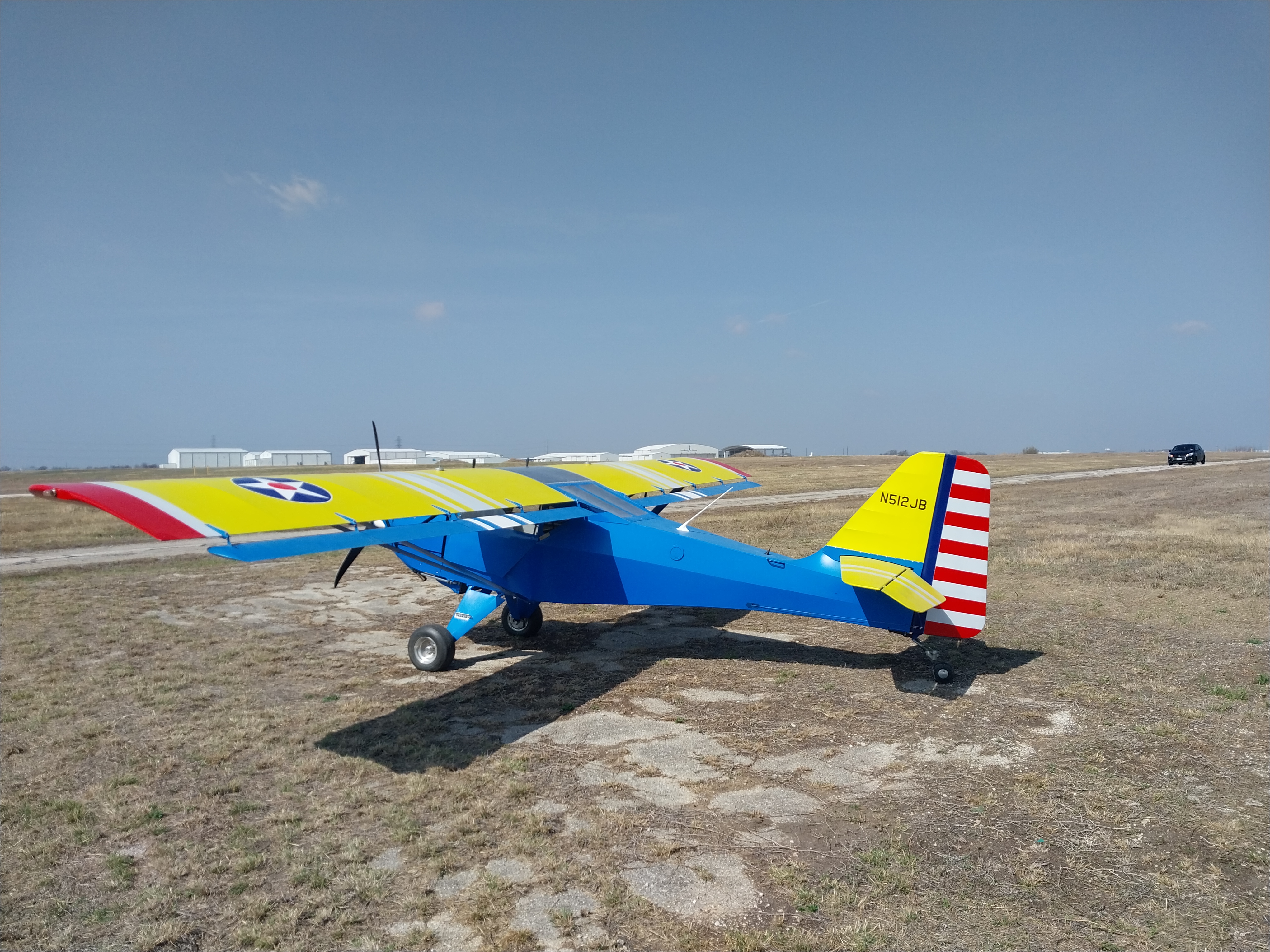

My kitfox came in within a pound of yours!
-Jack

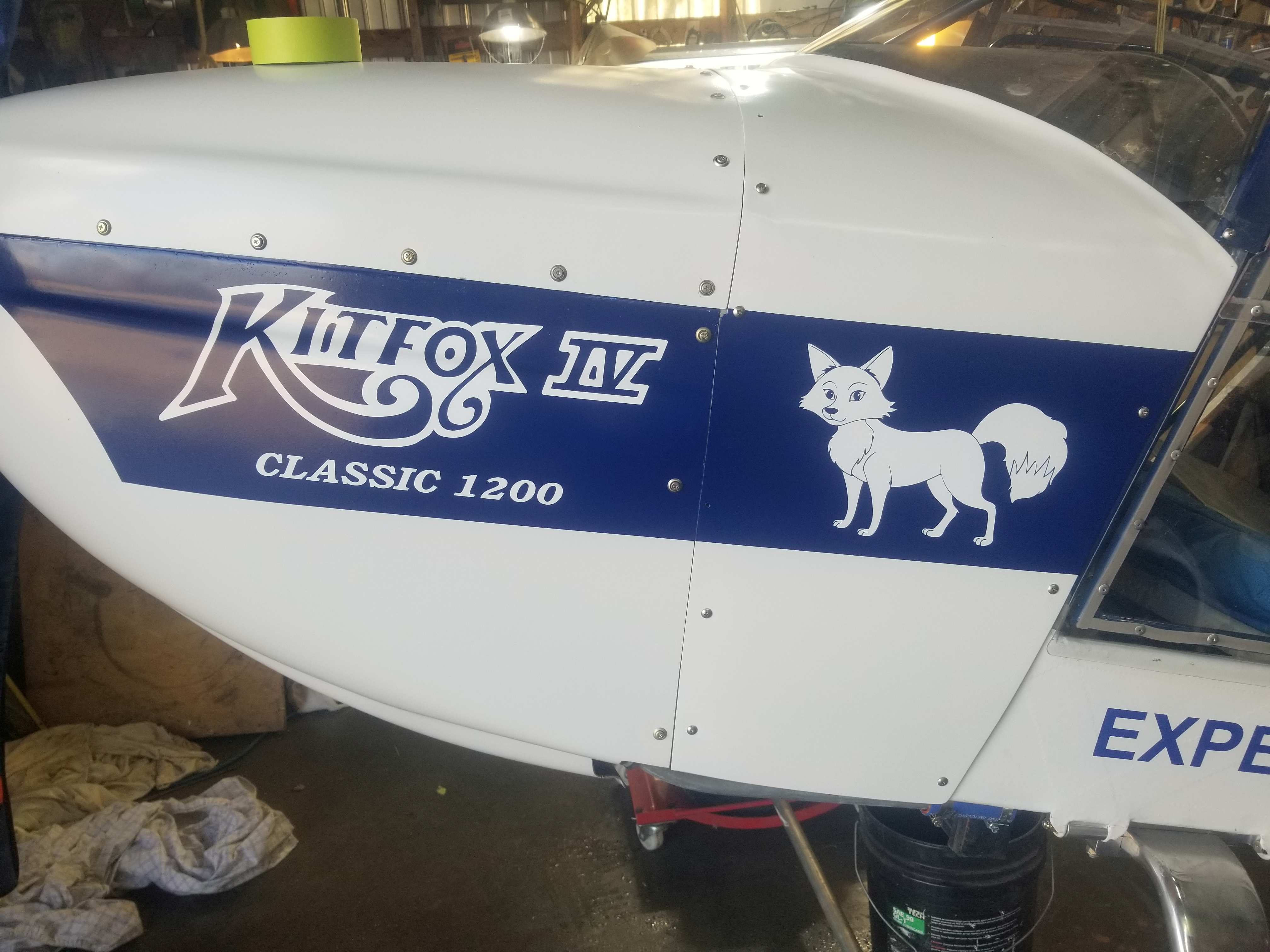

Looks nice.  I messaged my DAR today, and he sent some forms including a copy of a program letter.  I had sent him one that I reworked that a DAR had a friend of mine use in Arkansas.   My DAR suggested going with the task based phase 1, I've got to research it some more.  I don't really mind the 40 hours  setup, usually I just fly close to home by myself anyway.  Not sure yet which way I'll go.  JImChuk
PS  Got any decals for the cowl yet?  A friend of mine made mine, I came up with the pictures and he has the machine to make the decal.  I'm sure he still has the files....

I like the decals, but think the bump cowl would get in the way.  I kept fighting the oil cooler installation, couldn't make it fit, until I made the (used) round cowls 3 inches longer.   Jack
Just planning on the 40 phase 1 myself.  And yes, it seems that the 582 round cowl needs to be extended 3" for a 912 installation.  JImChuk
