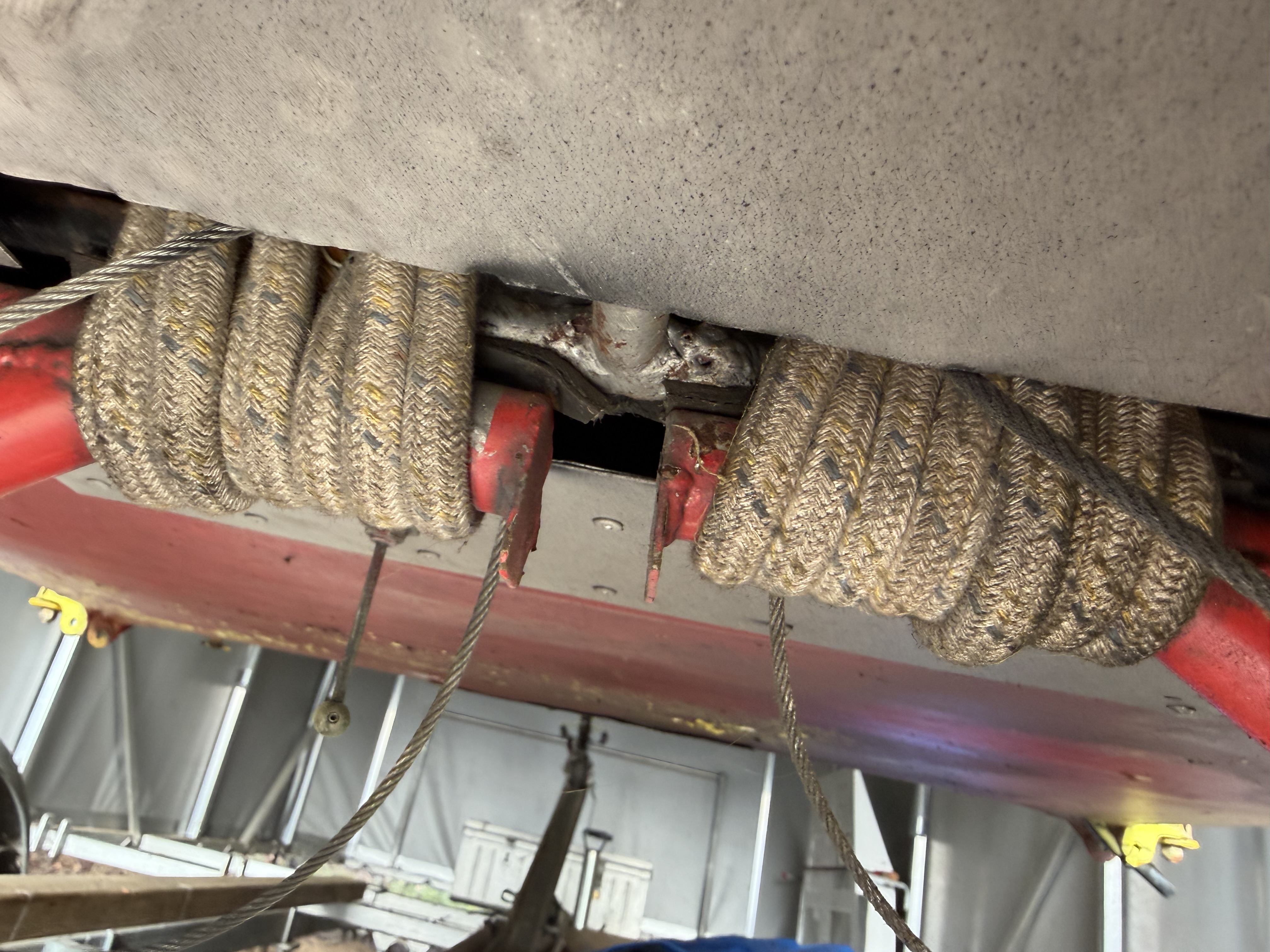

Hi,

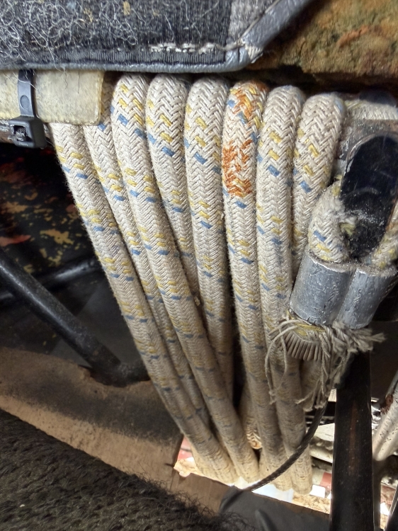

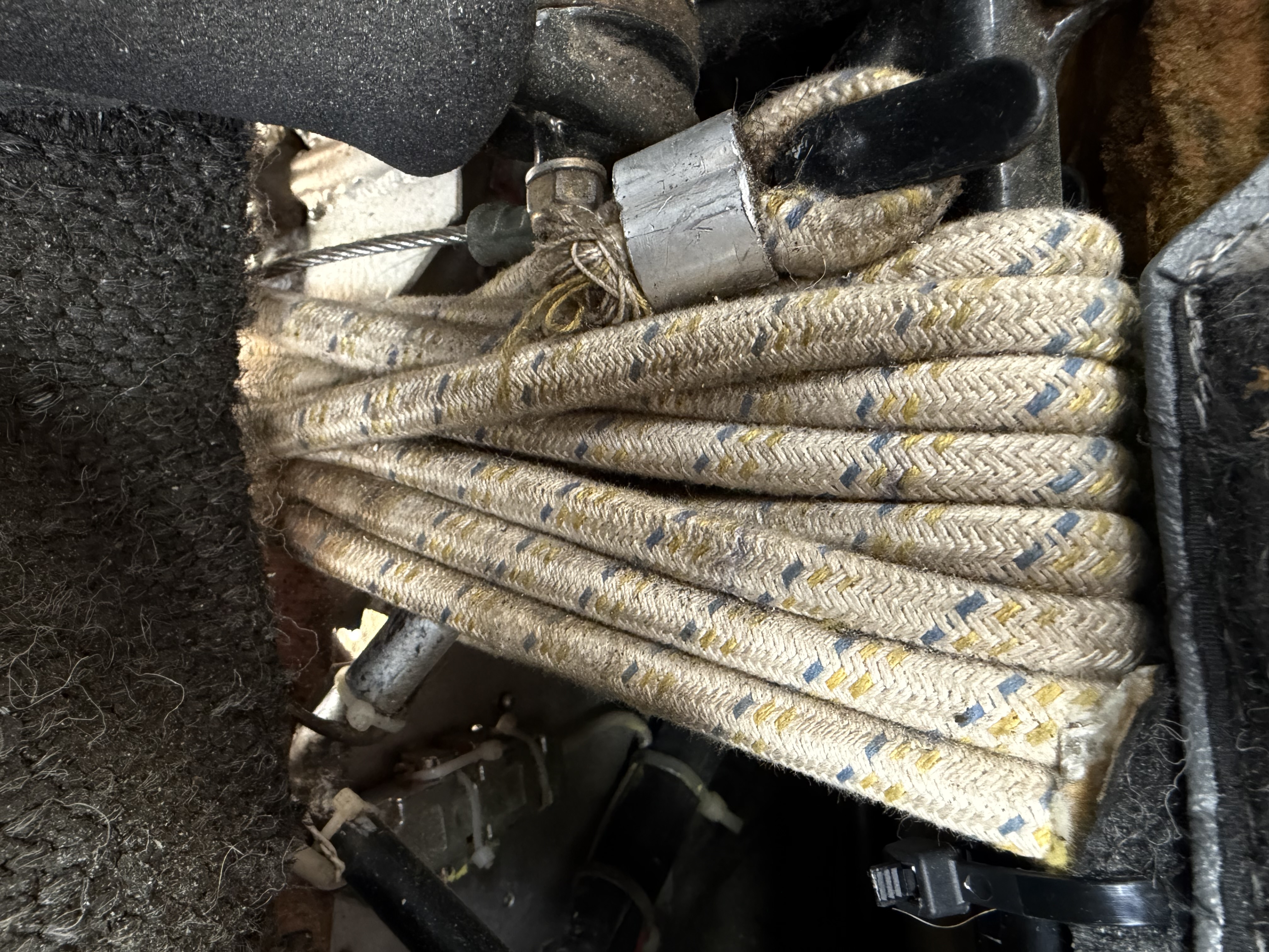

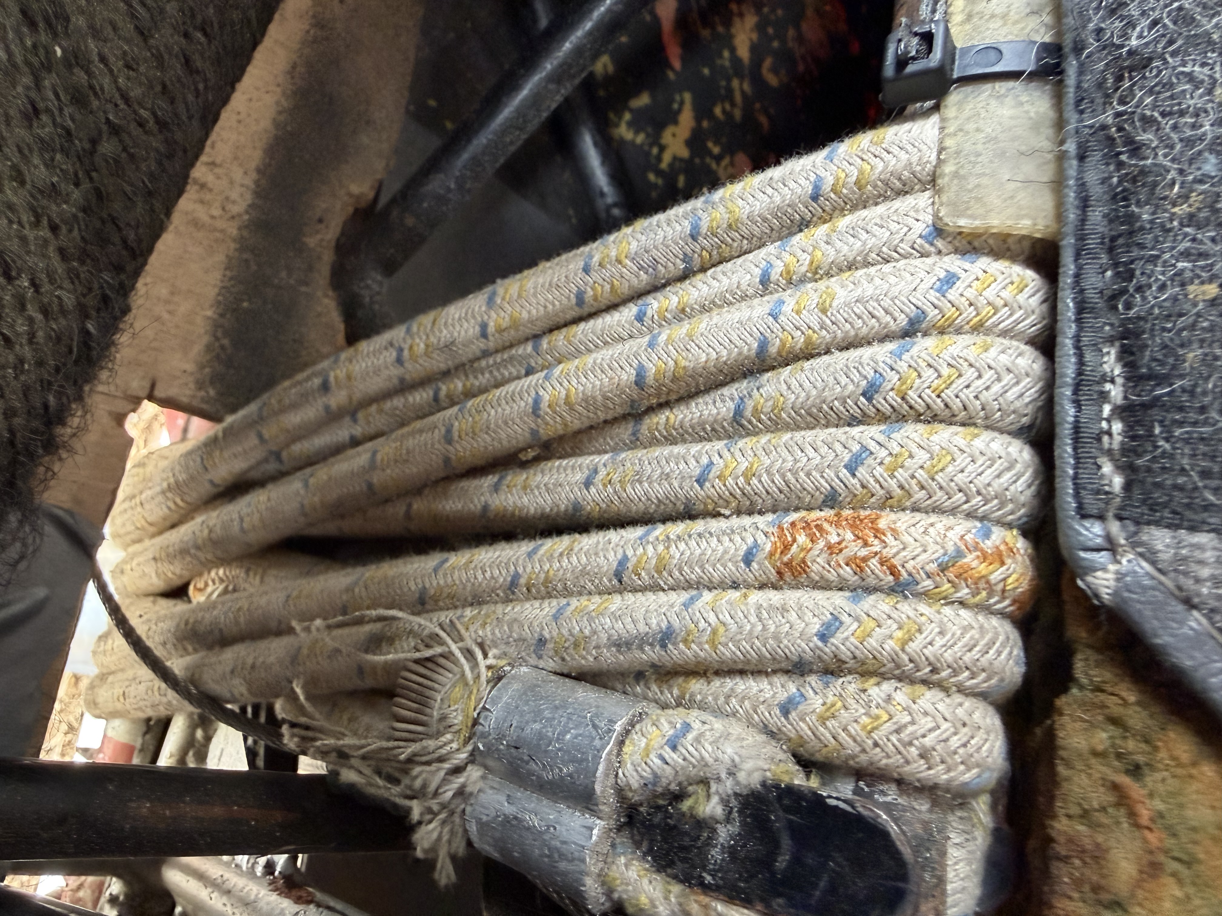

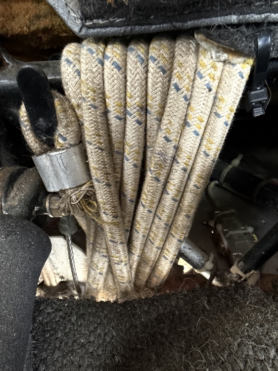

I am about to change the bungees on my Avid Flyer Mk4 HH. It has the wide gear. The old bungees have 8 wraps, instead of the 7 that I understand you get with 90" bungees.
So, should I keep the 8 wraps and what is then the length of the bungees?
Thanks!
I did a bit of searching and found this thread on the same topic as your question,  At the end, Doug Holly says bungees are 100" and 8 wraps.  Others said 1/2" diameter, but I wonder if you can get 8 wraps of 1/2" bungee in there.  Compare what you already have on that one.  JImChuk
Airdale Wide Gear - Avid Model IV - AvidFoxFlyers Forums
Thanks, Jim! That's great information. I will check again what is already on but it seems to be the 3/8" cord. /Johan
