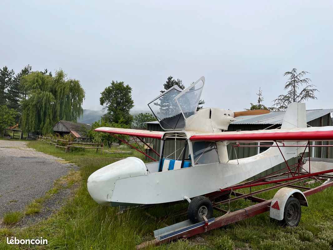

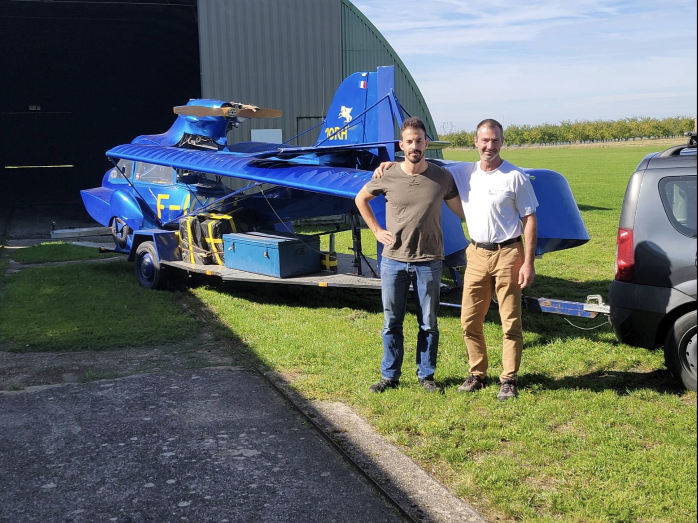

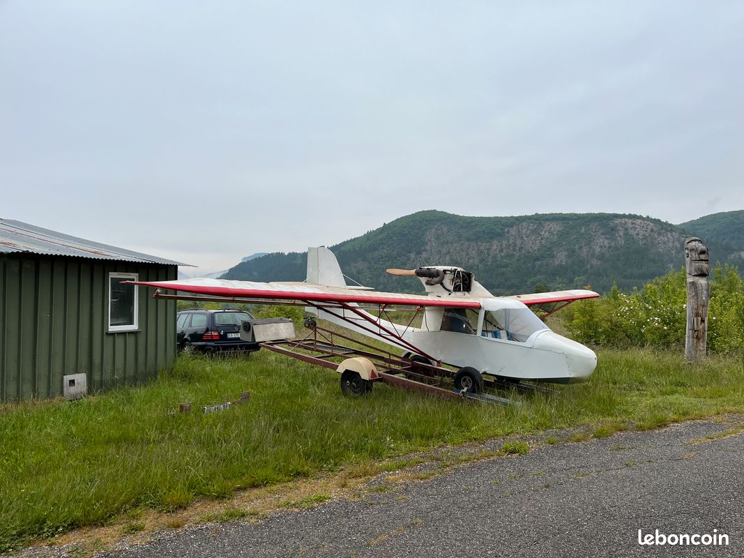

In addition of Laurent, we welcomed Christophe, from the south east of France. With his father he currently has a "landphibian" aka an amphibian kit finished without the hull and the retractable gear.
Here is an update on the work in progress :
Landphibian : We will give Christophe and his father the hull of our first amphibian project, which they will use to convert there landphibian into a fully capable seaplane.

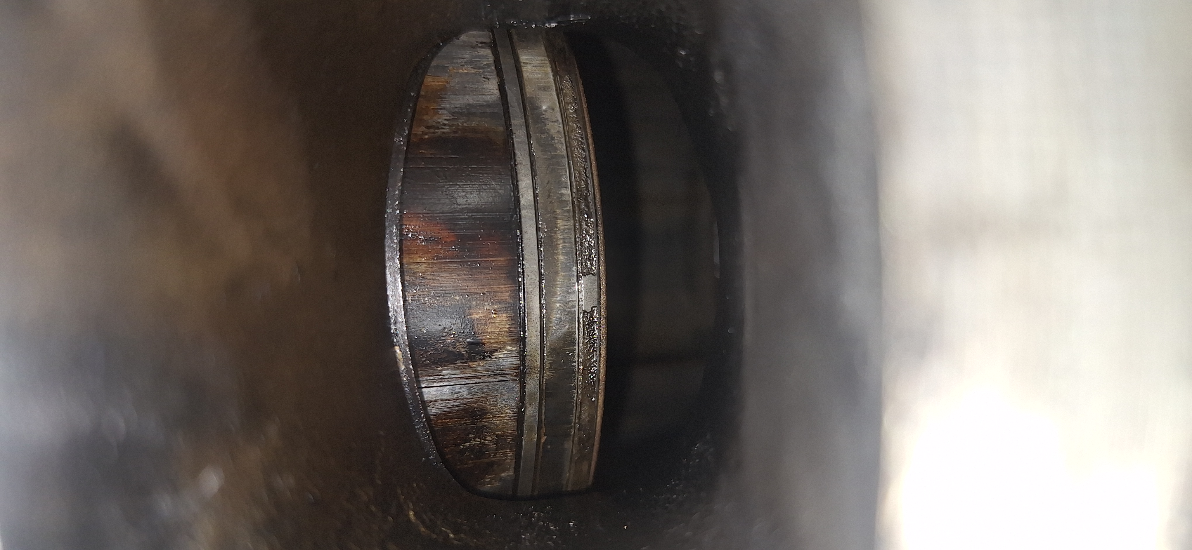

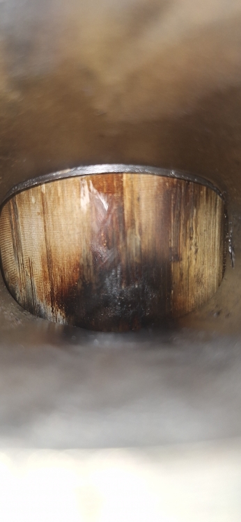

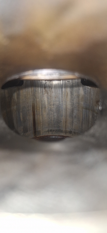

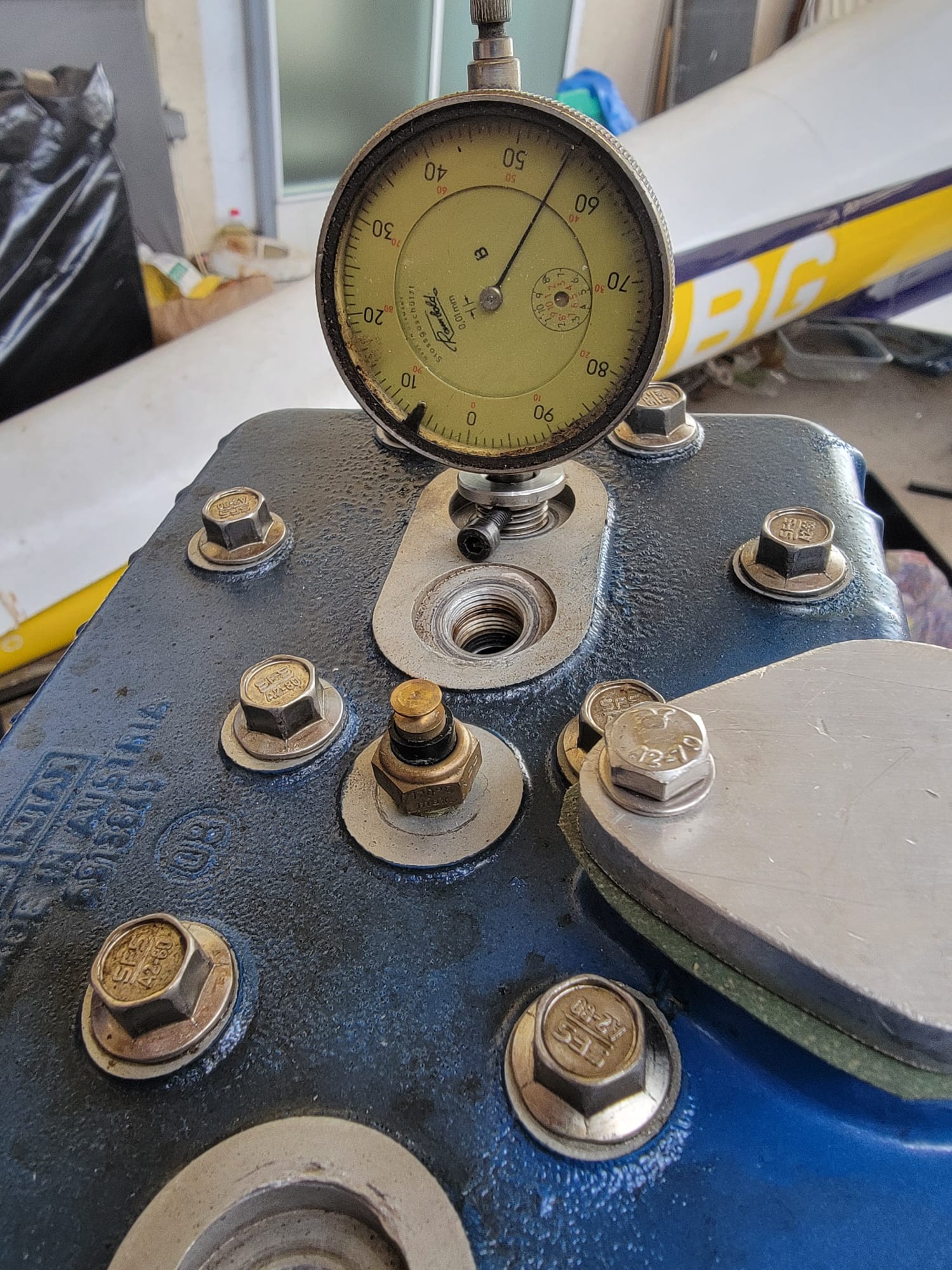

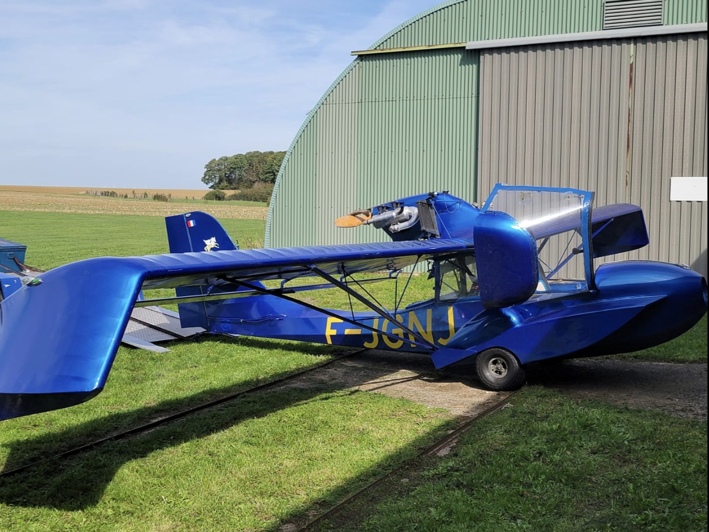

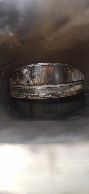

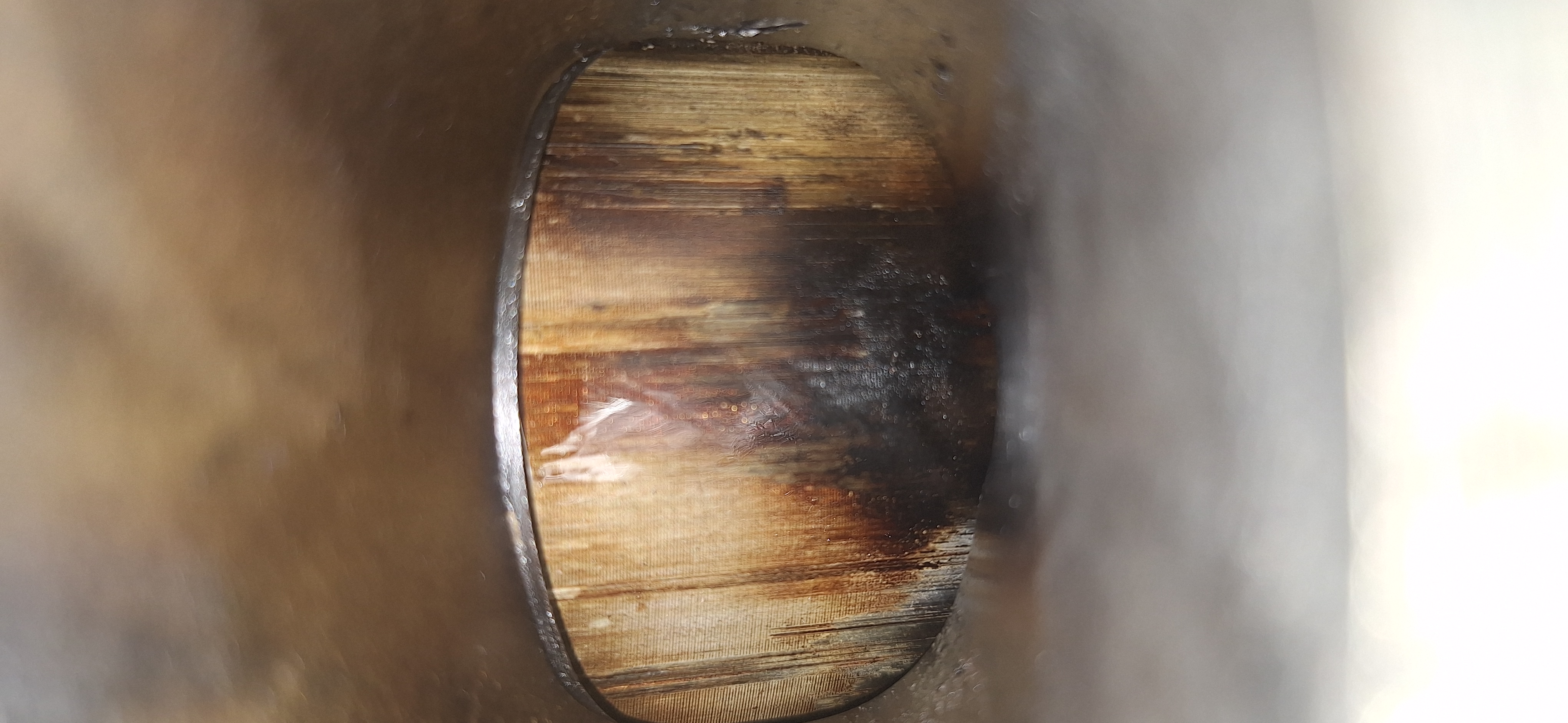

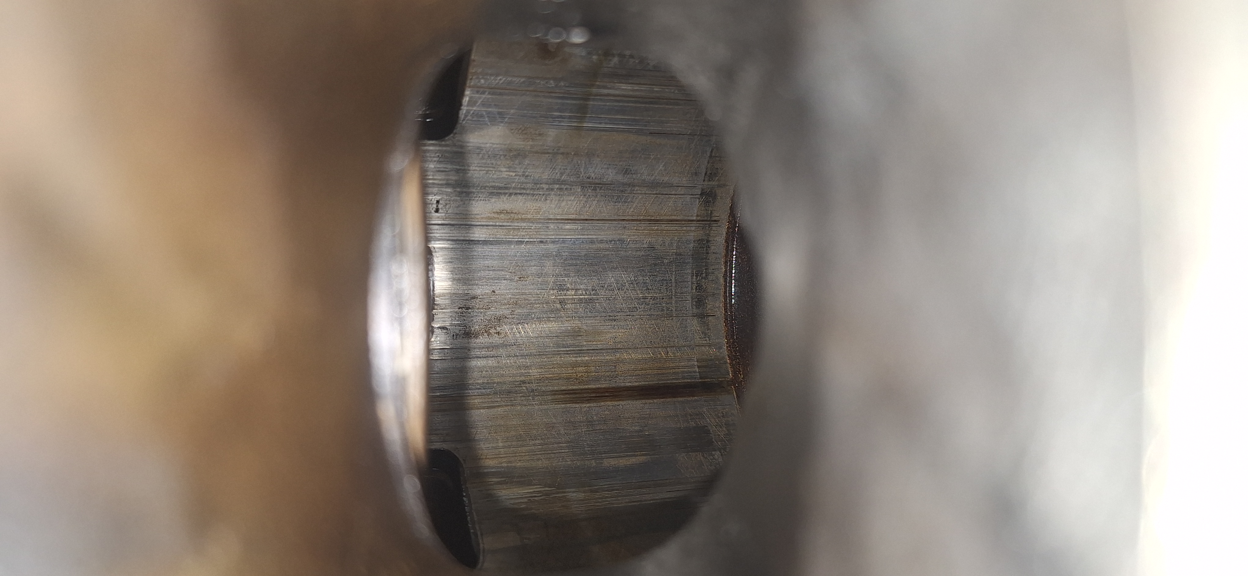

New one! :  Laurent and I recently acquired another frame, built in France at the time, later based in Germany. It was registered F-WRFE then F-PUZL then converted as an ultralight as F-JGNJ. As the world is small, Christophe's father owned and operated it for a few years in the 90's.. It is essentially complete and not far from being ready to fly, however we discovered signs of overheating in the front cylinder. We need to dissassemble the engine. We planned to have it done by spring!

Overheating marks in n°1 cylinder (rotax 582) on F-JGNJ

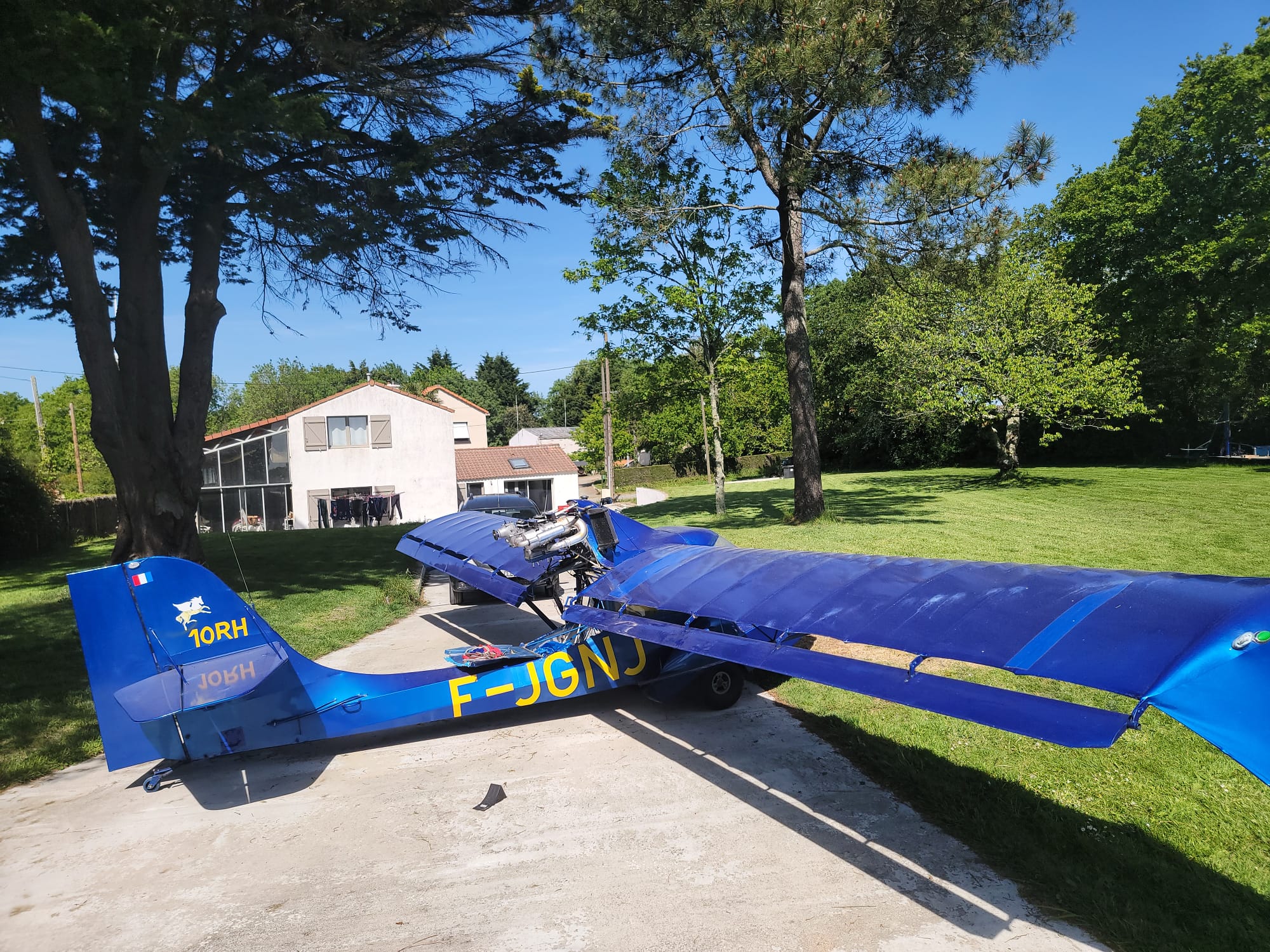

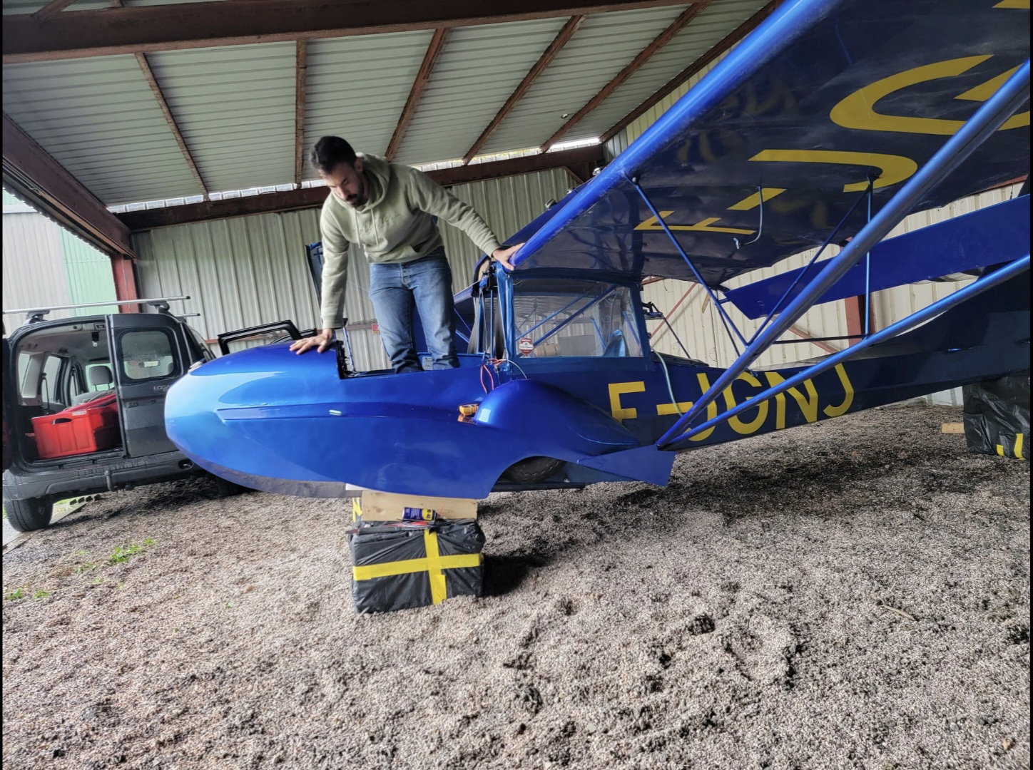

Sone pictures of F-JGNJ!
Trés Bien!

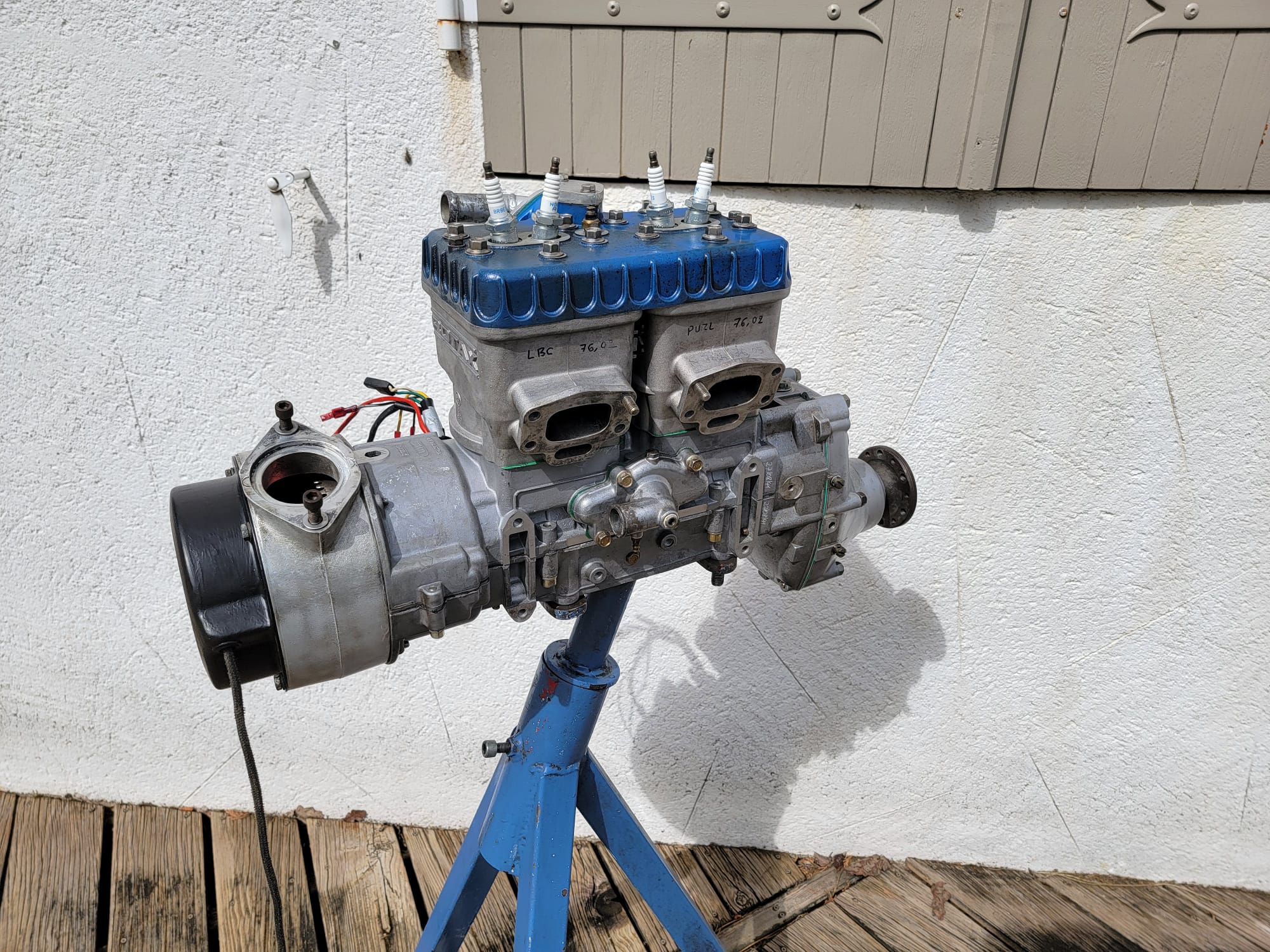

Update time!

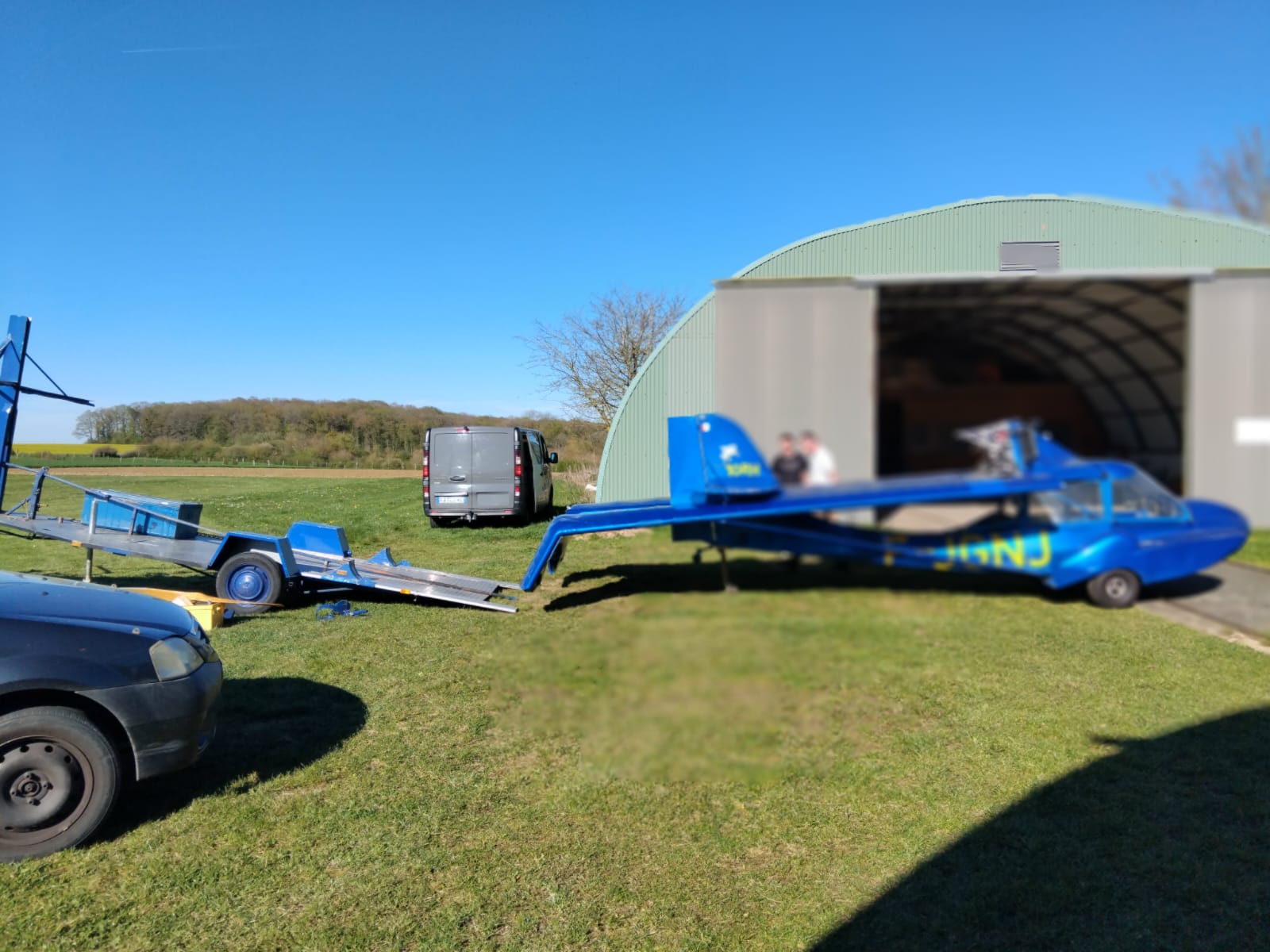

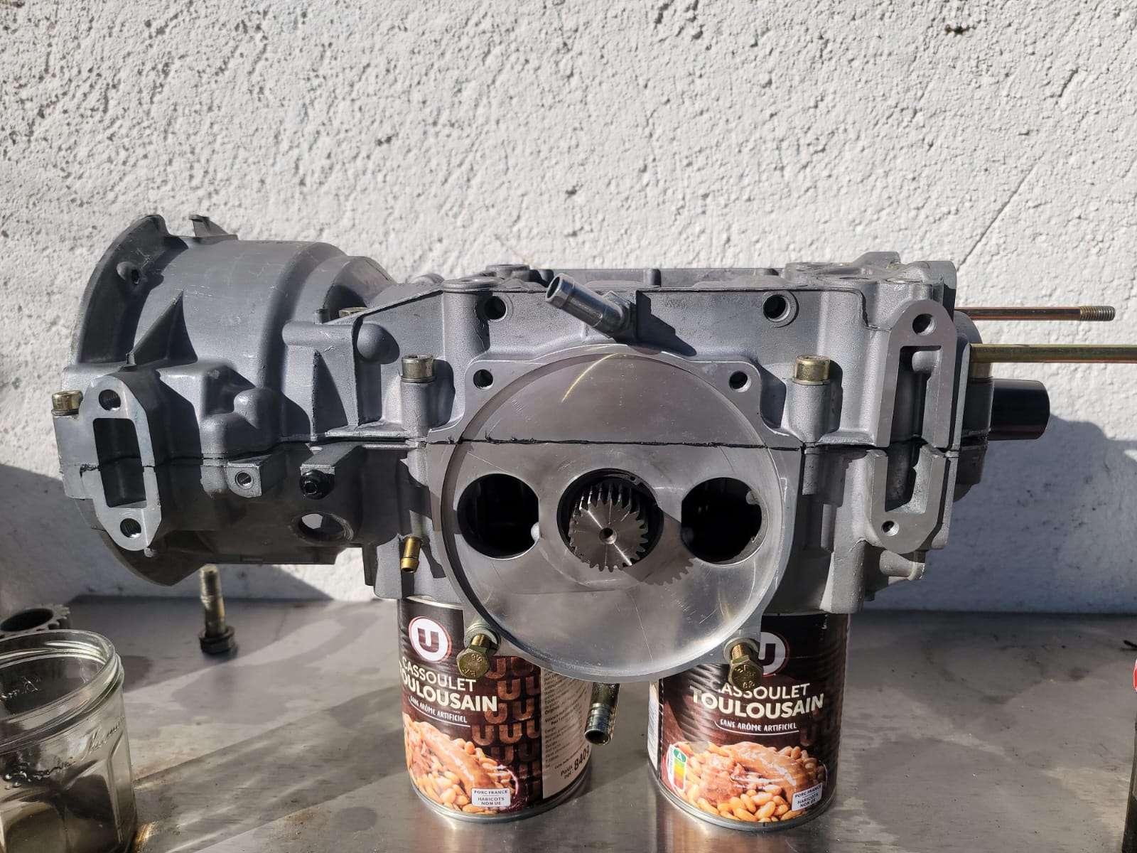

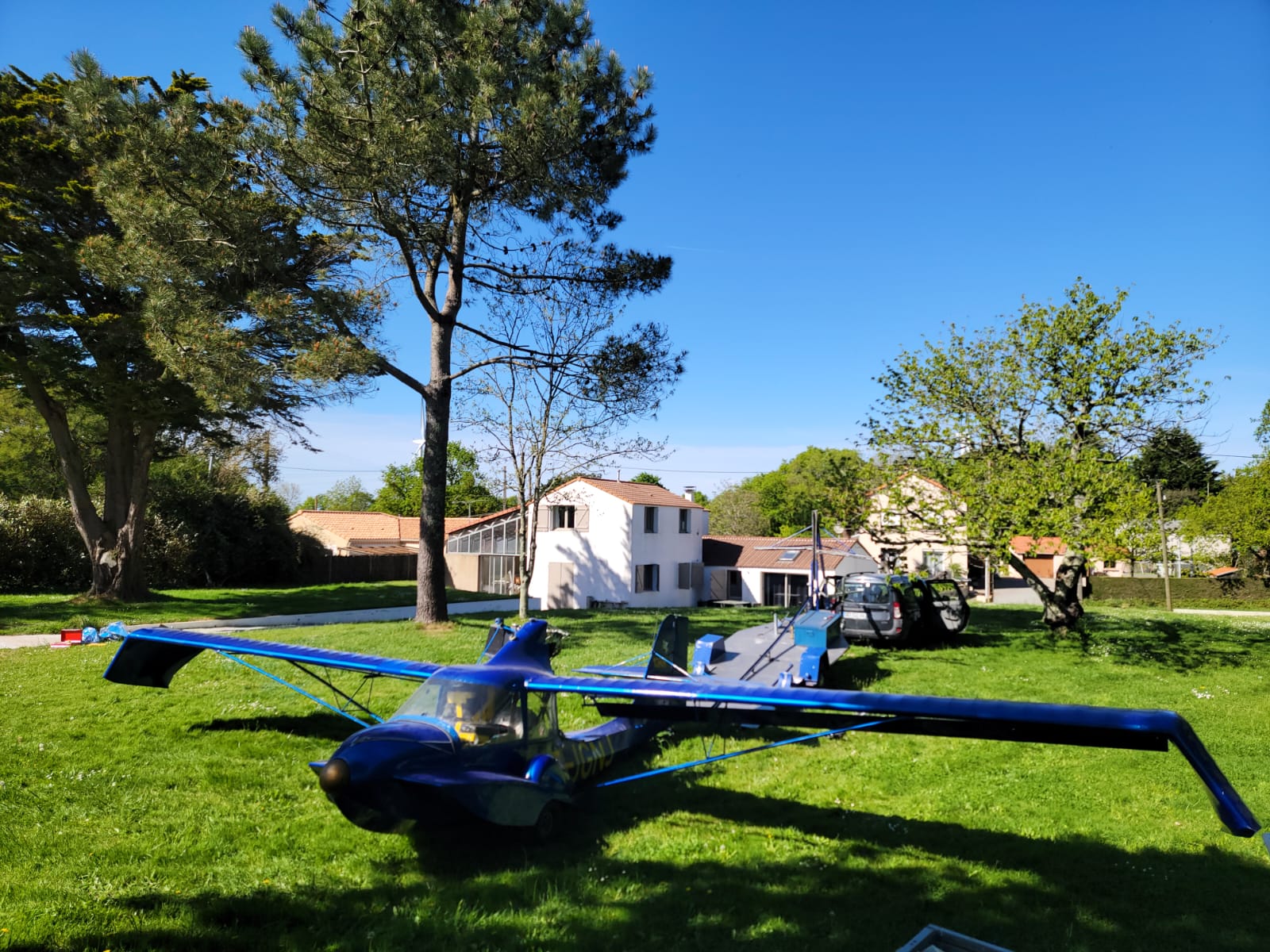

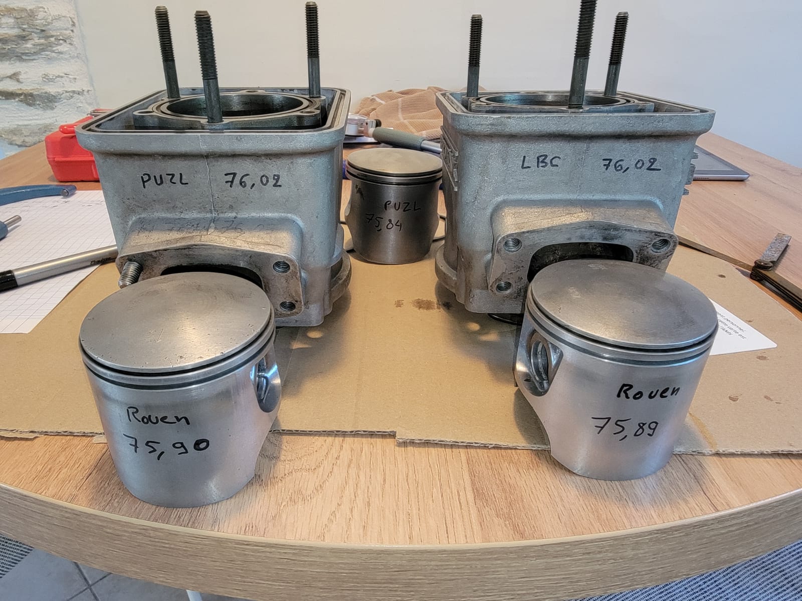

After spending winter in the east of France at my ultralight trike airfield, our blue amphibian resumed its journey to Laurent's place for final maintenance before flying.
The engine had been taken of already and entirely overhauled by Laurent, following the overheat discovery on cyl n°1 due to a lack of lubrication.

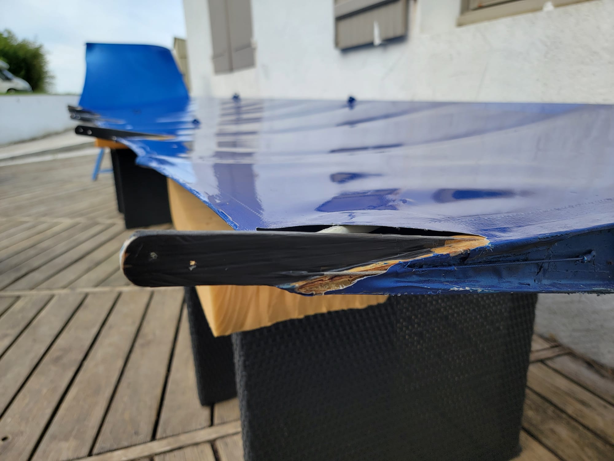

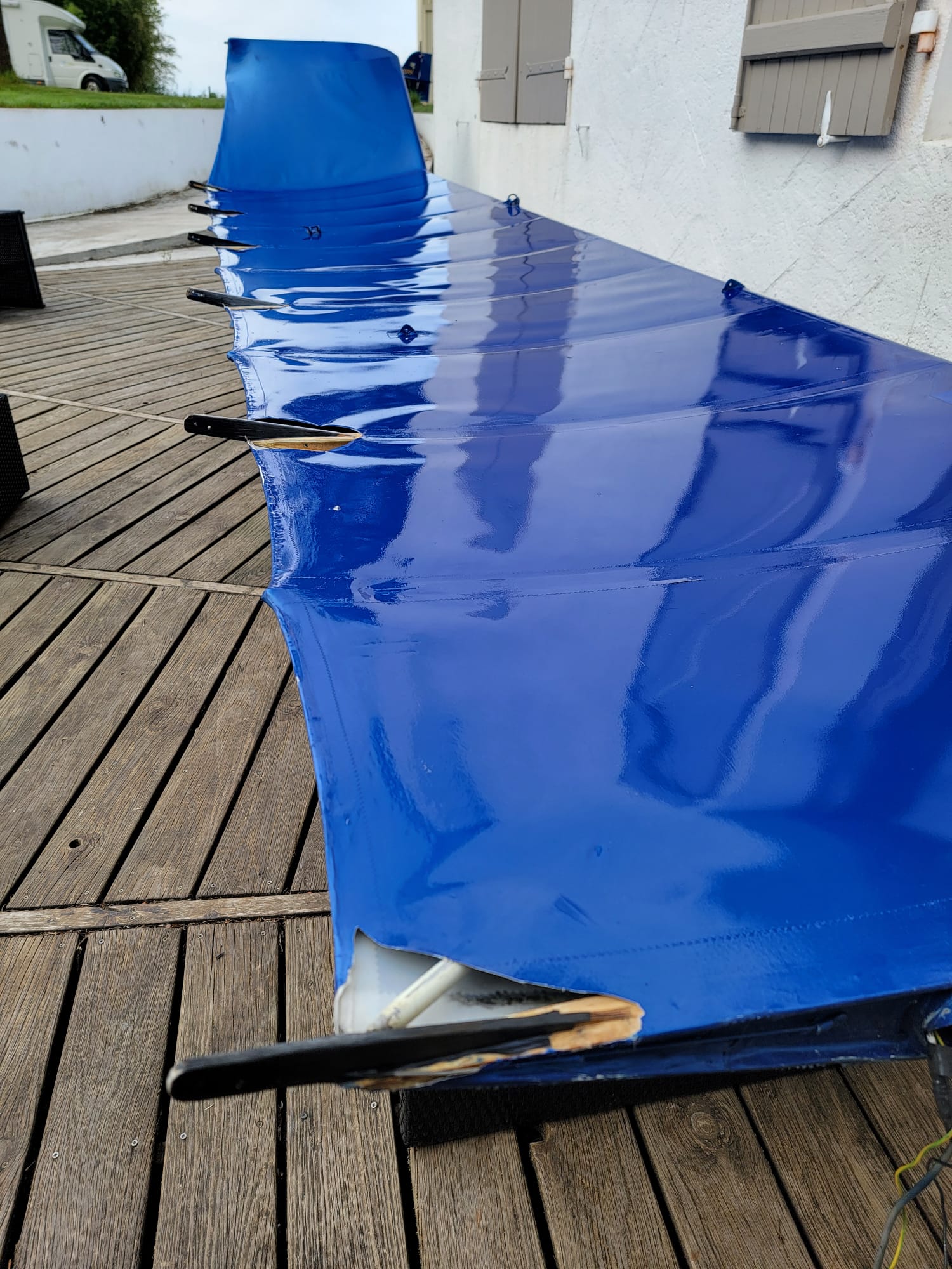

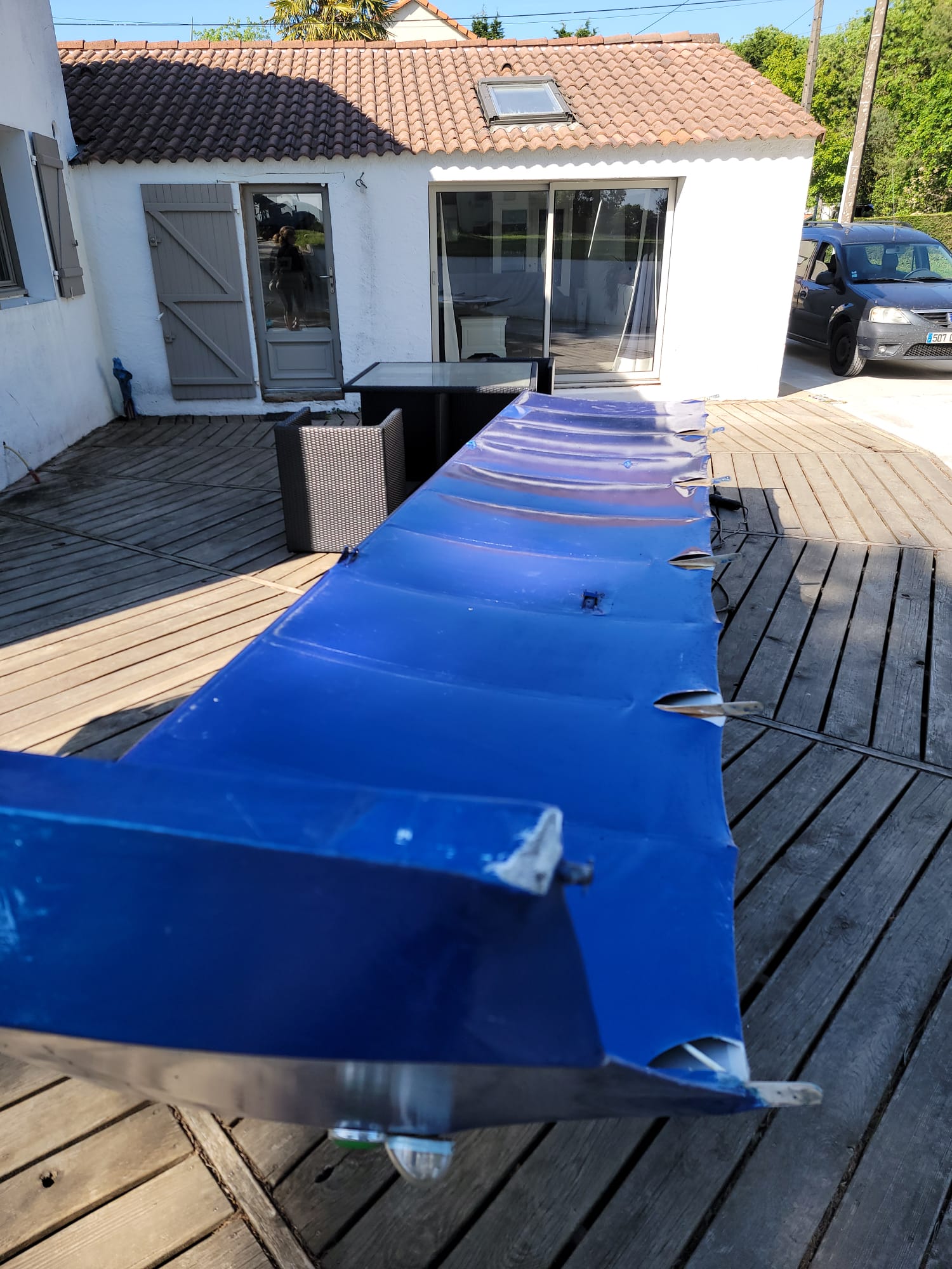

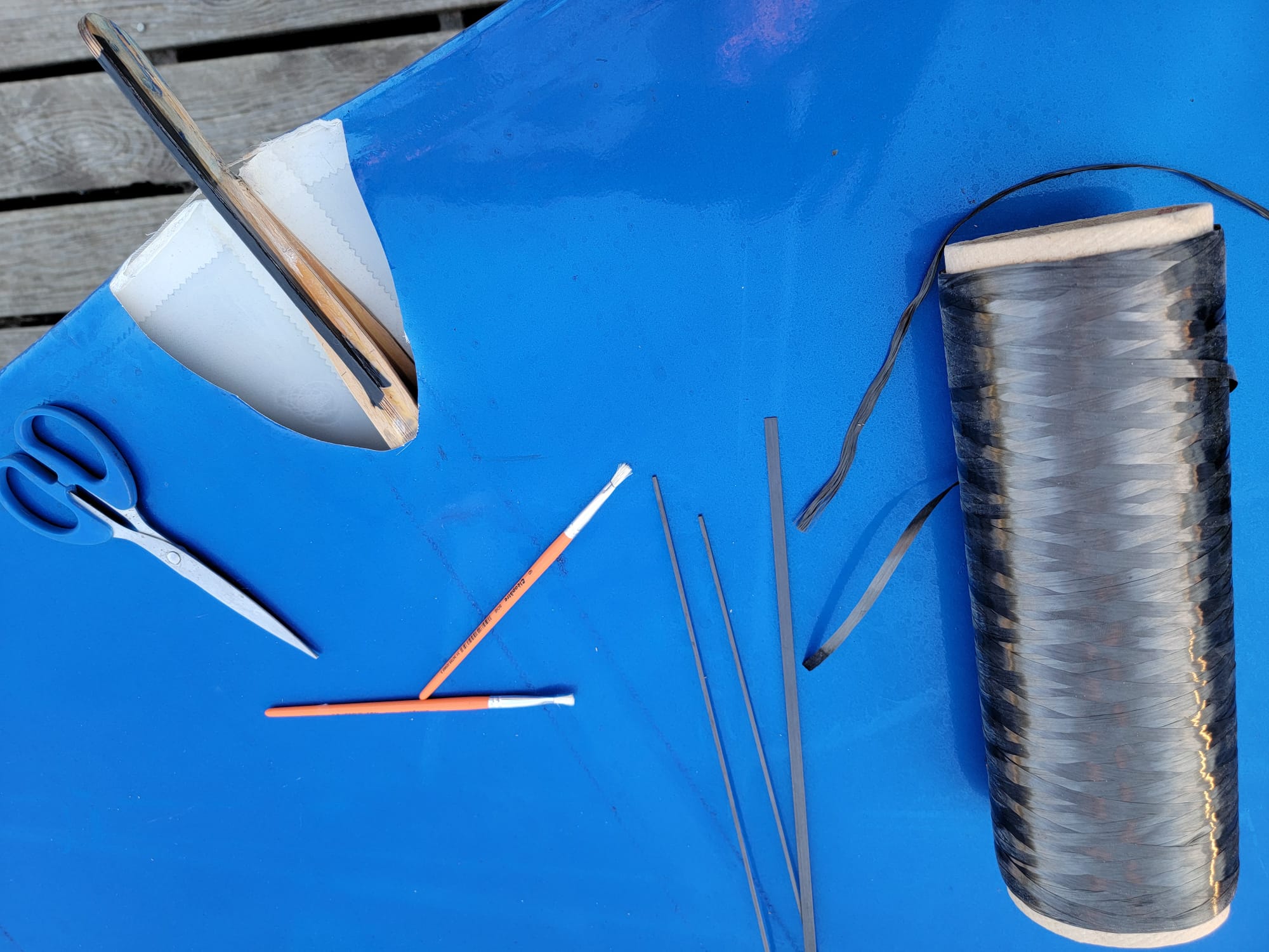

 Engine is back on the frame at last. But more work is needed on the wings, especially on the ribs. They will be stengthened with carbon fiber.
We hope to fly this summer!
