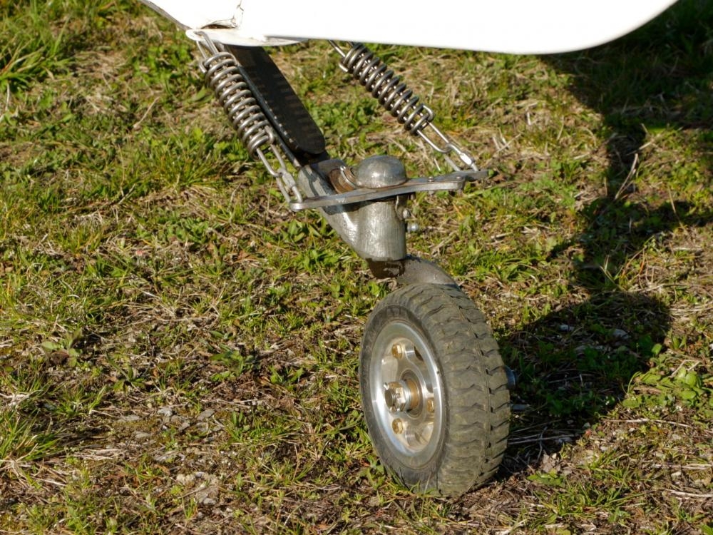

Posted 4 Oct 2025 Hello, I need to replace my connector spring kit on the tailwheel.Inch or mm, I can deal with both. Here under is an example of usefull data:Could anyone tell me dimensions of their springs?Of course, I could buy the Spruce kit, but I would prefer to avoid this cost.https://www.aircraftspruce.com/catalog/lgpages/maule_springs.phpThank you, Share this post Link to post Share on other sites

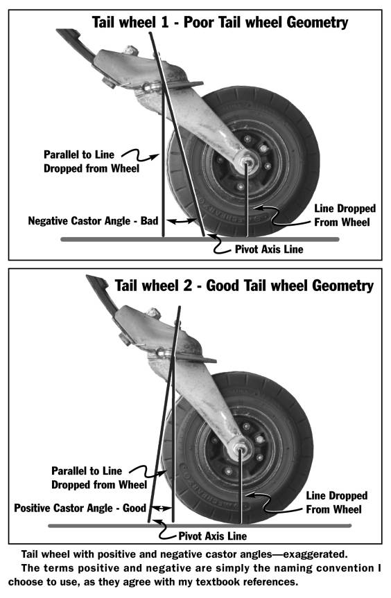

Posted 6 Oct 2025 If the kingpin angle is correct, it won't shimmy. Share this post Link to post Share on other sites
Posted 7 Oct 2025 Thanks guys!Av8, what do you mean by correct kingpin angle? Share this post Link to post Share on other sites

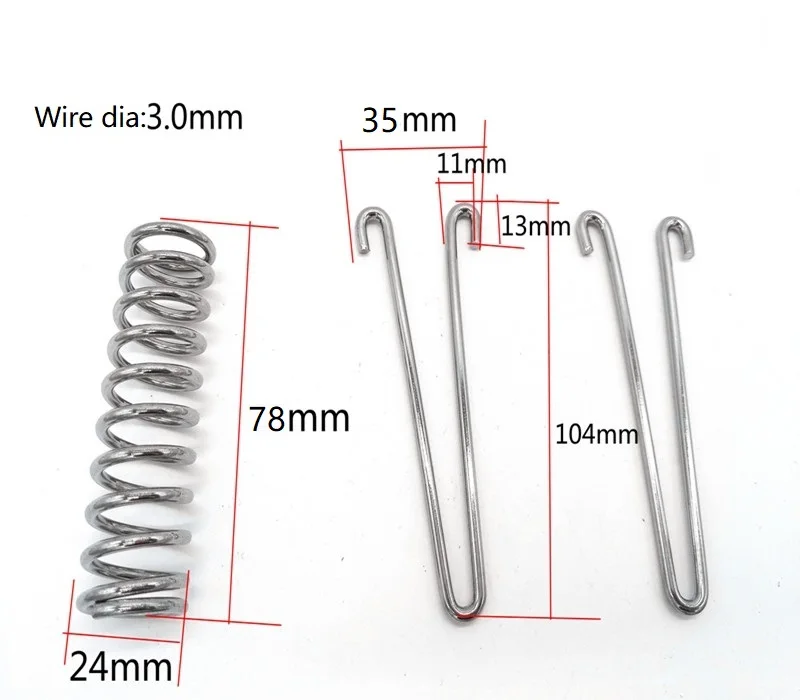

Posted 11 Oct 2025 Hello,Thank you, but this is not what I'm looking for. I am looking for the dimensions of the springs holding the tailwheel.Avidventurous, since I live in Spain, I cannot open the link to the Homedepot link.In fact, I was wondering if one of you wouldn't mind measuring his own tailwheel spring.Length, diameter, and diameter of the wire. Share this post Link to post Share on other sites
