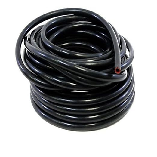

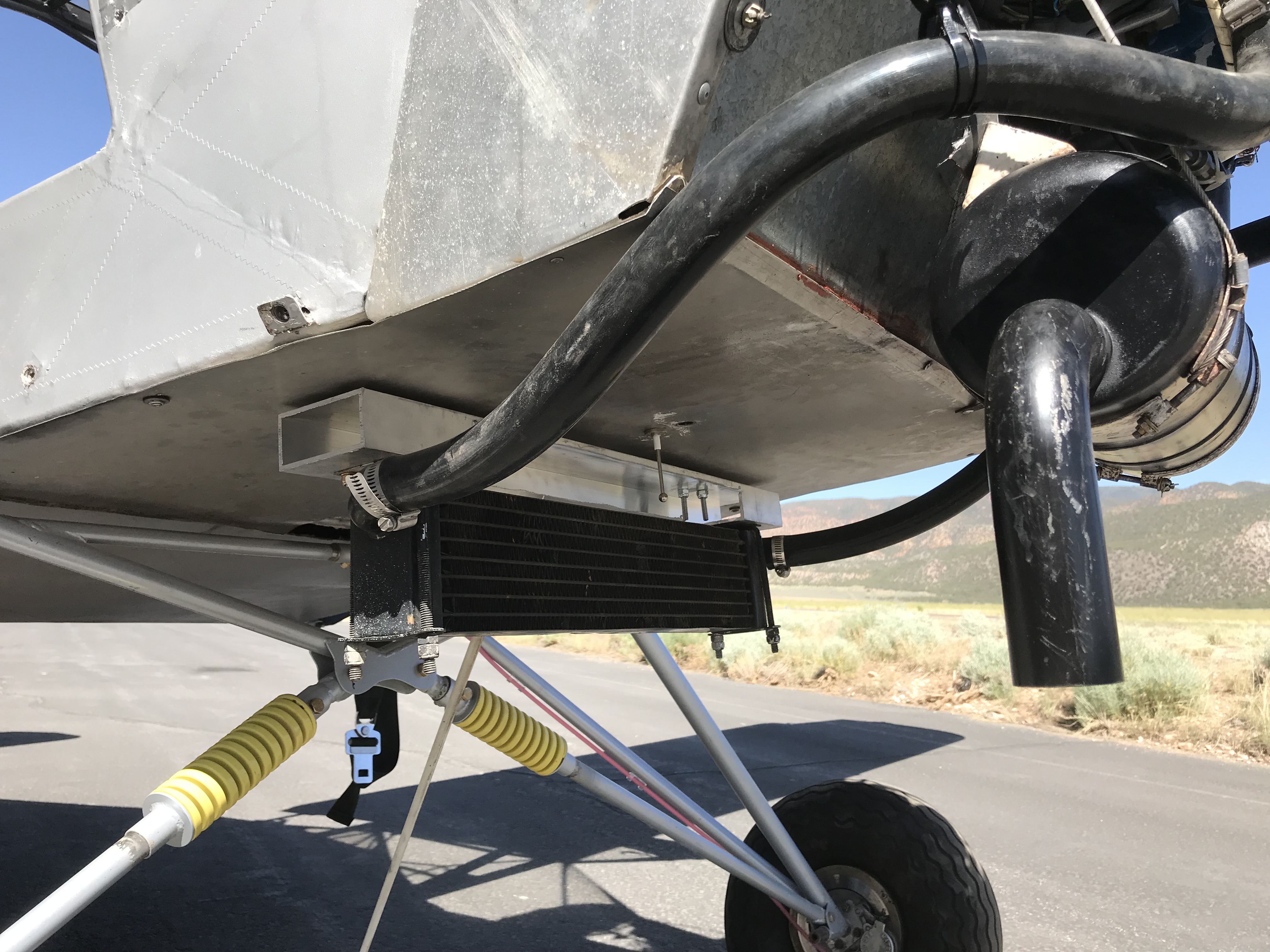

I redid all my water hoses, used this stuff, it is 6-7 years old, looks brand new. Amazon:
HPS 1" ID Black high temp reinforced silicone heater hose 10 feet roll, Max Working Pressure 50 psi, Max Temperature Rating: 350F, Bend Radius: 4.5"
