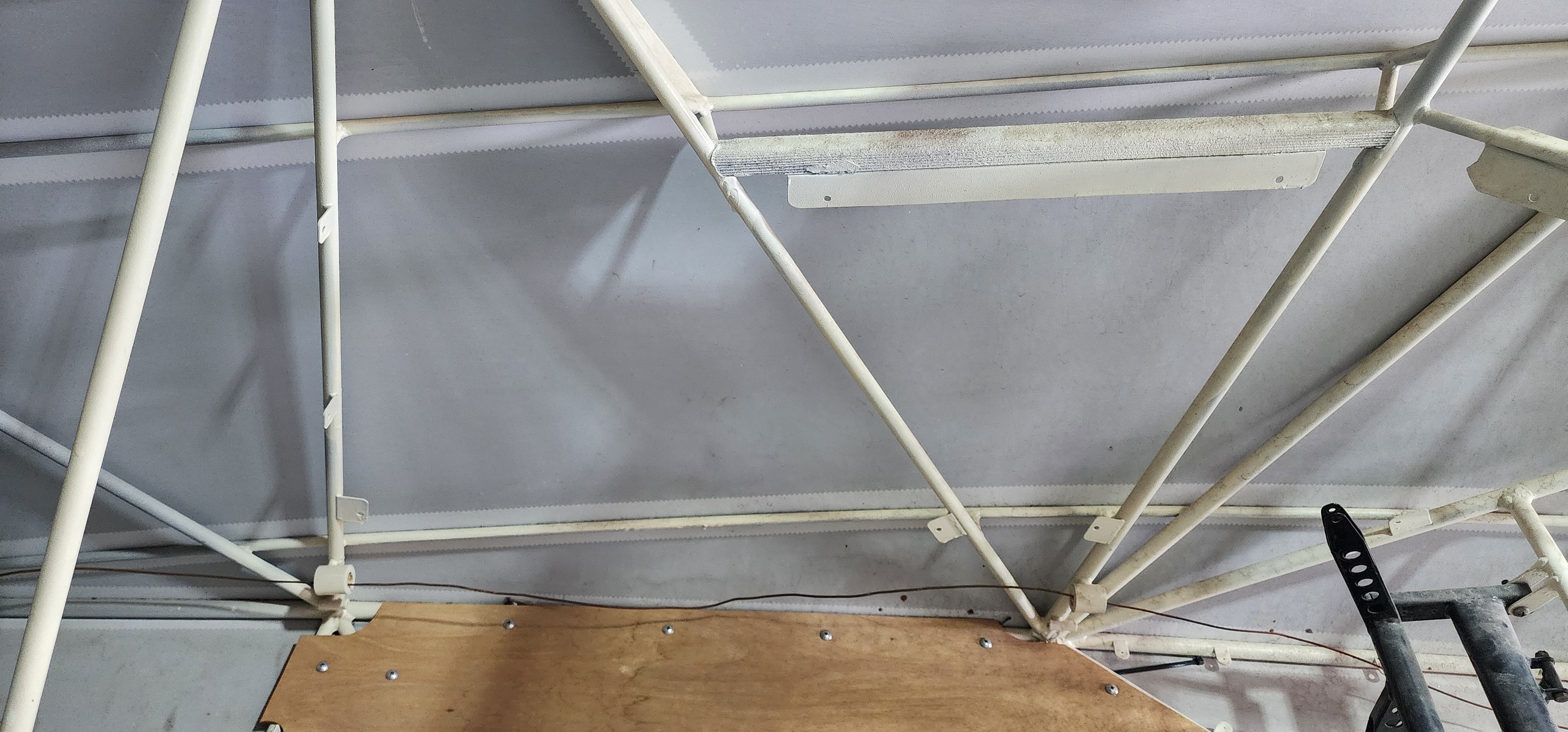

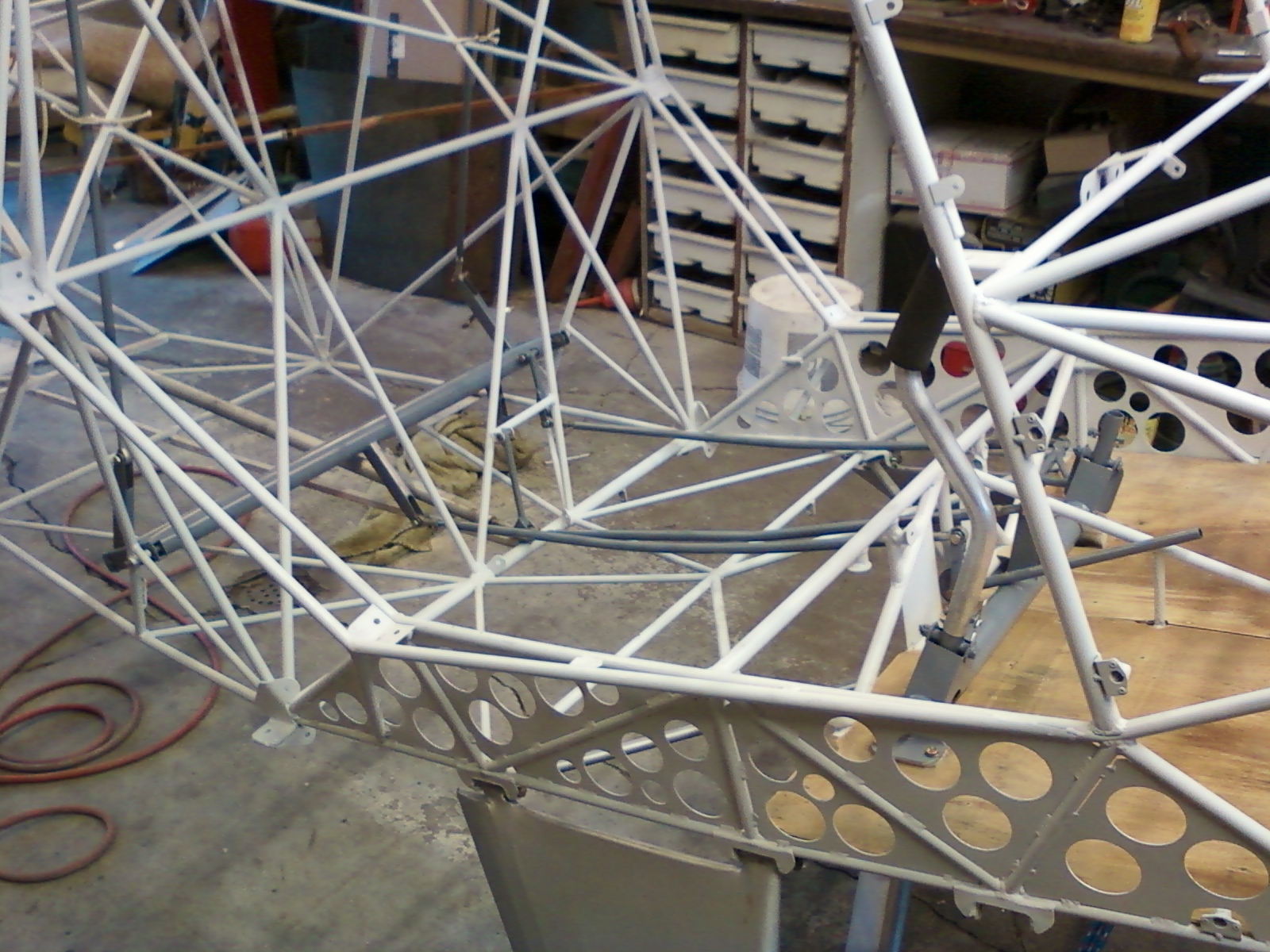

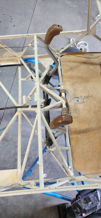

Hey Chris, the simple answer is clearance. The current setup has interference issues. What i have seems to be from a kitfox which has the elevator push rod down the center of the fuselage, whereas the magnum runs that push rod down the left side of the frame. Not to mention the controls I have are not mounted to the factory locations and other mounting holes have been drilled to accommodate. You can see in the pictures the bosses with the wire running through, that is where the elevator push-pull tube goes. The other picture shows how someone tried to run what i currently have, with the tube in the center. Not only does the stick run out of aft elevator because of the bungee support tube, but the linkage for the elevator does not clear as well. I hope that all makes sense.

That first picture sure looks something like the Kitfox 4 and newer mixer control.  JImChuk

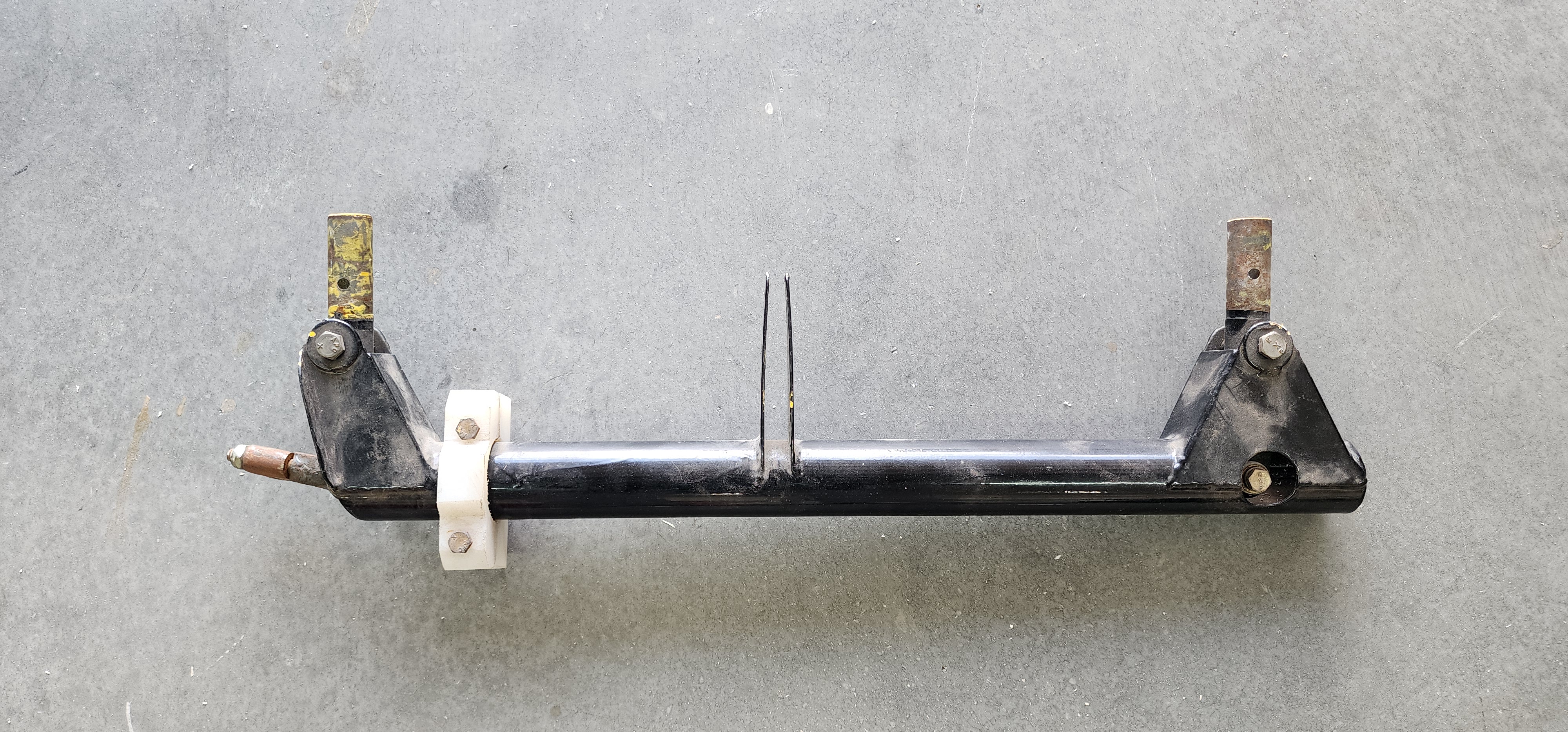

Yes, I believe so. Here is a better picure of the bellcrank. Either way i need something to work, this just doesnt seem the easy way to go. This is why im looking for the original parts. Any suggestions would be greatly appreciated. Thanks
