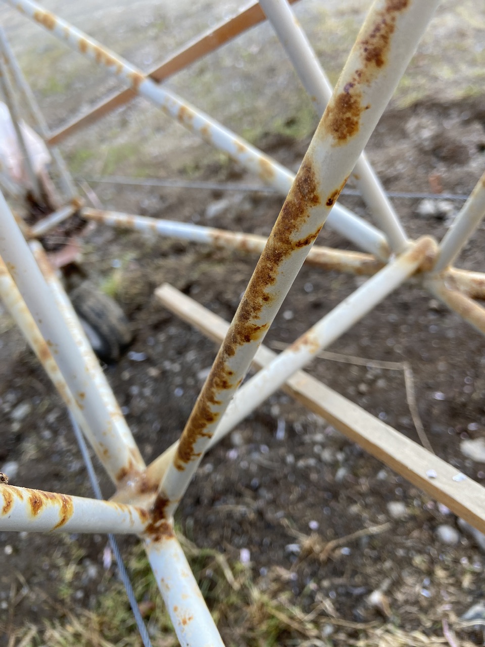

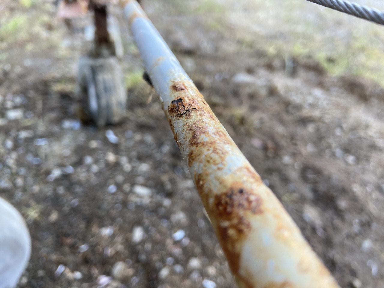

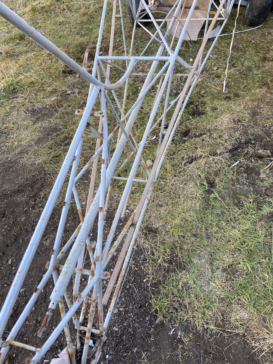

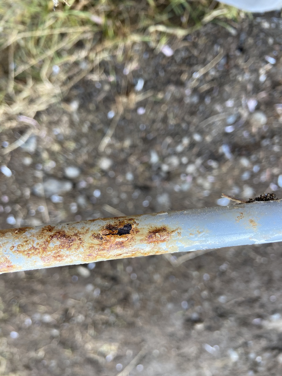

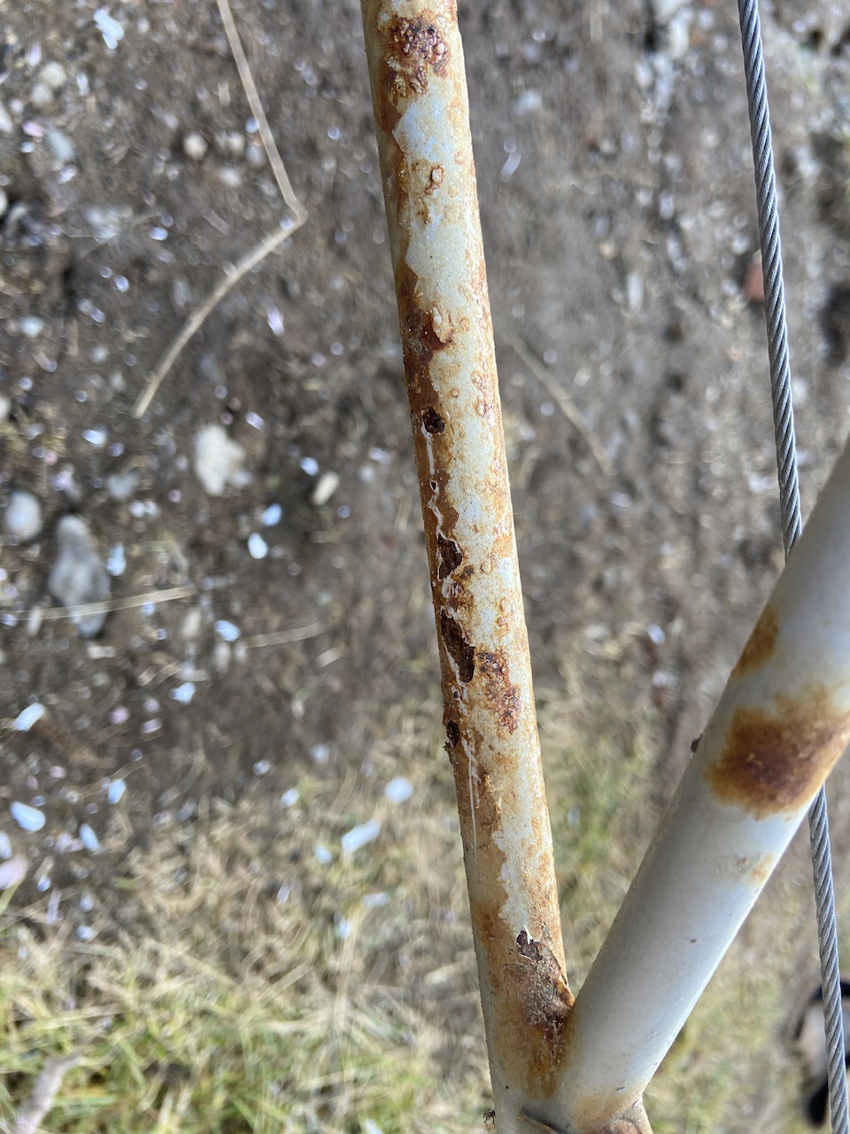

I took some better pics of corrosion on the airframe. You can see there’s orange peel, so there’s definitely pitting. How deep that goes remains to be seen.

I got the fuselage stripped. I doesn't look as bad as I thought it would. I picked up a free sandblaster, that appears to be in working order. We'll see how deep the pitting is, once it's blasted.
