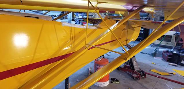

I picked up the airplane 2 days ago. As you can see from the pictures, the airplane took a pretty big hit but it could have been worse. here is my assessment of the airplane and damage.
  1. Aft fuselage bent much like typical trailering damage
  2. Tail spring destroyed
  3. Rudder destroyed
  4. Fin bent
  5. Windshield broken
  6. A few slightly bent tubes in the skylight area
  7. Flaperons have some damage
  8. Left forward strut tube bent
  9. left fiberglass wingtip has hole from trailer jack.
  10. Left tip rib cracked
  11. Both flaperons damaged (maybe repairable)
  12. Various holes in fabric to repair
  13. Upper forward cowl  damaged (repairable)
  14. One prop blade chipped
  15. Go through engine and systems
That list probably sounds worse than it is. The airplane isn't really in all that bad shape. The farmer was a darn good craftsman and it was a very nice build. A month ago this was surely a beautiful airplane. It is a Kitfox 3 fuselage with Kitfox 4 wings and mixer assembly, so it is essentially a Kifox 4 1050 in my book. It has a 582 gray head so I will be doing a pressure test of the seals before running it. This airplane should be a pretty quick fix, so my other Kitfox project will be on hold until this one is flying.
I've had the airplane for 2 days and here is what i have accomplished.
  1. Replaced tail spring with one I had
  2. started straightening of the aft fuselage
  3. removed windshield
  4. removed rudder
  5. removed fin fabric and straightened fin
The fuselage straightening is being done like my first Kitfox that incurred a bent fuselage from trailering damage. I removed the top fabric and corner tapes from the bay that was bent. I then used my crude tool for straightening the tubes to slowly pull them as straight as possible. The diagonals straightened just fine, but the longerons are kinked a bit, so will need to be replaced in that bay. These pictures were before some of the tubes had been finish straightened, but even so the fuselage looks a lot better than it did before.
I'm now waiting for my tubing order which includes tubing to enlarge the fin and rudder to later kitfox 4 size. Hope to have fabric on the aft fuselage by next weeken.
